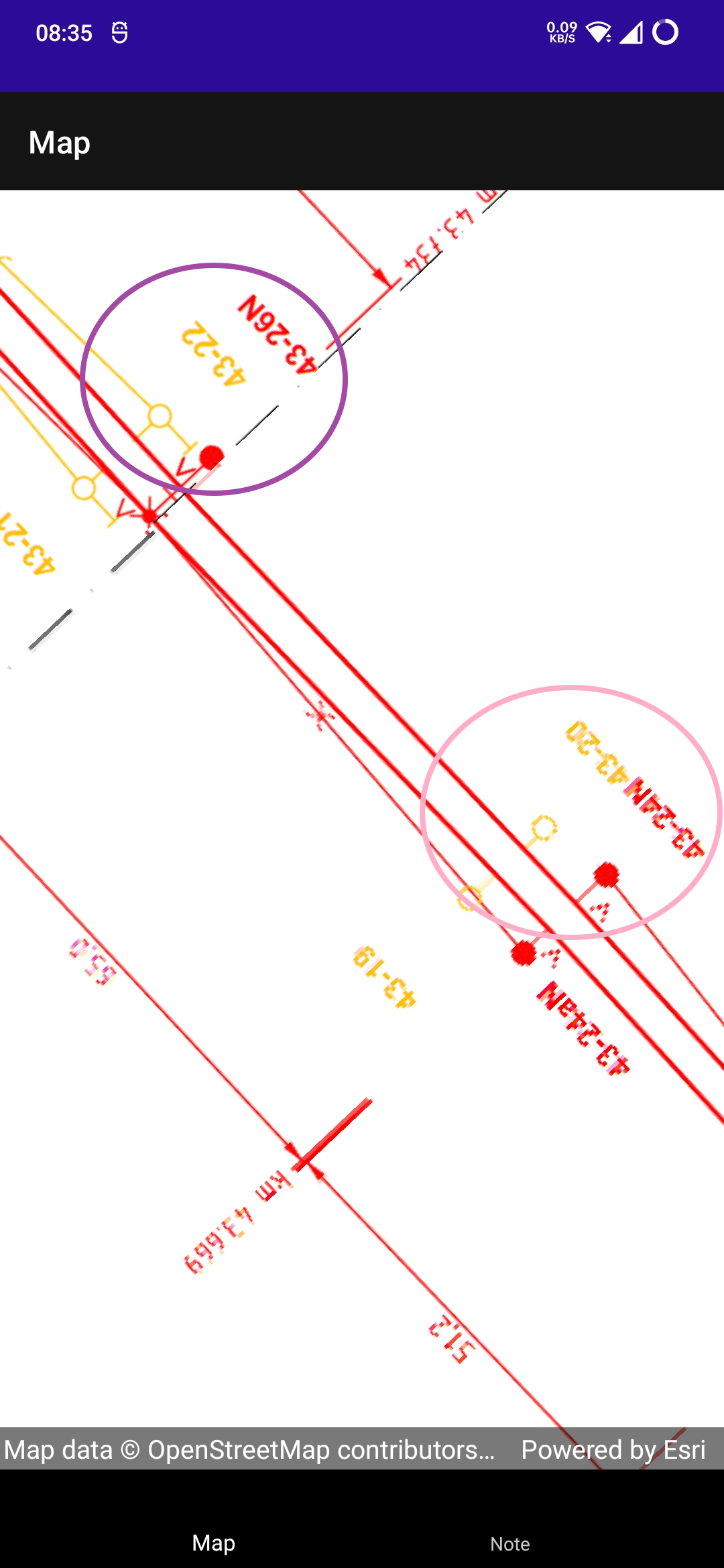

The KMZ you see in the screenshot is the one with index 4. It seems only every other KMZ is rendered pixelated. But if I only load index 4 its also pixelated... so it cannot be the order or index in the layers...
If you scroll a little to the north-west you get a black broken line which shows the border to the next KMZ. That one is rendered properly (purple circle) compared to the pixelated one (pink circle)

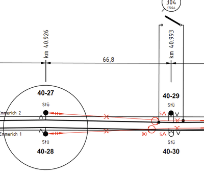

I've just found out this issue is not related to a full/whole image! Here is the KMZ with the Index 00 opened on my PC via IrfanView at 200%:

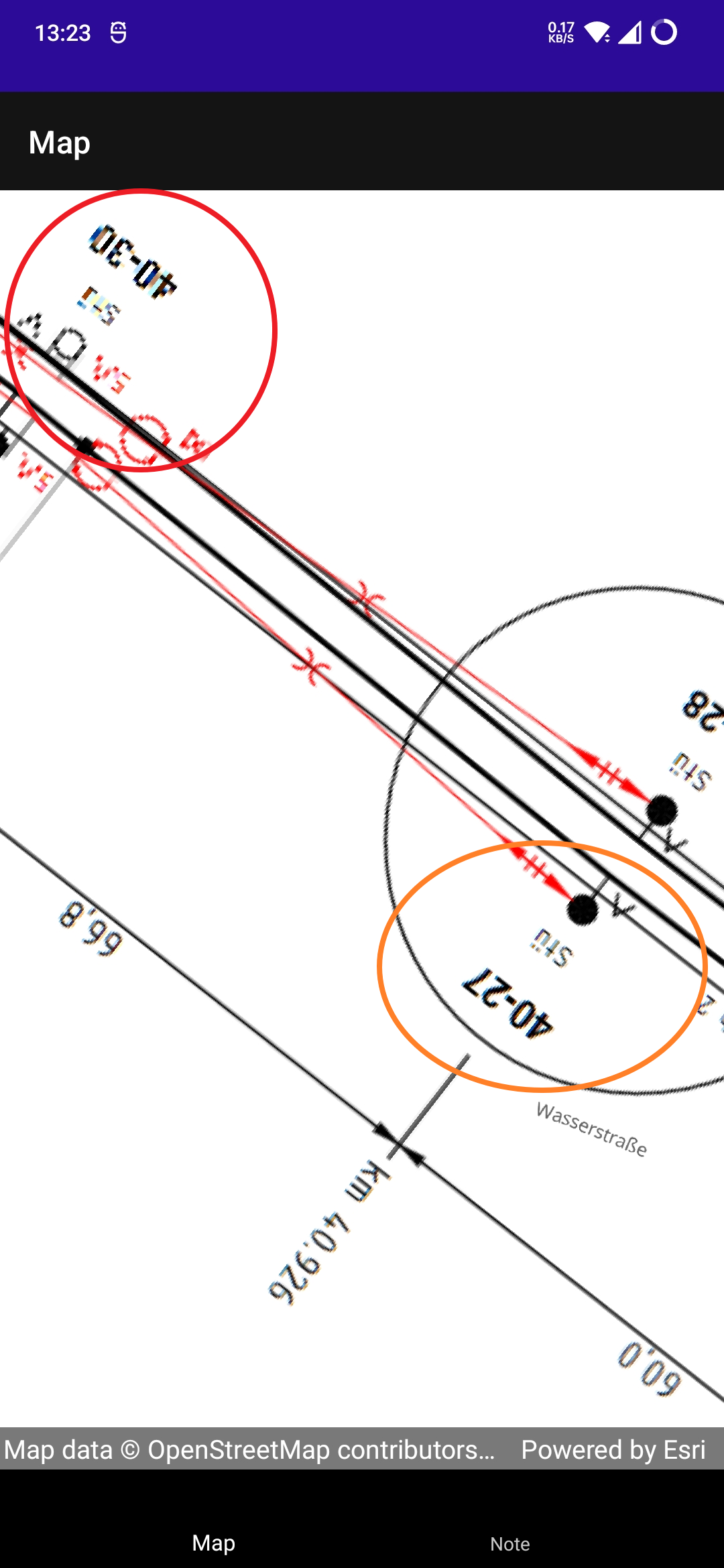

On Android the pic is upside down and looks like this:
You see "40-27" is way more pixelated than on Windows... AND... "40-30" is way more pixelated than "40-27" even both are from the same file (PNG/KML/KMZ)
