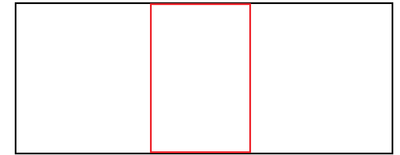

One more thing to consider: When calling SetViewpoint with a bounding geometry, we'll do the best to fix that geometry into the view. If your mapview is a wide landscape view (black box), and the bounding geometry is portrait shaped (red box), we'll fit the geometry to the view around the top and bottom:

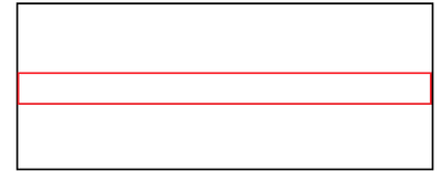

Similarly if the box is very wide, we'll fit it the other way, again guaranteeing that the geometry you're trying to zoom to is fully visible:
That means the box you're passing in won't be the box you get back out, since we have to adjust for the different aspect ratios.
