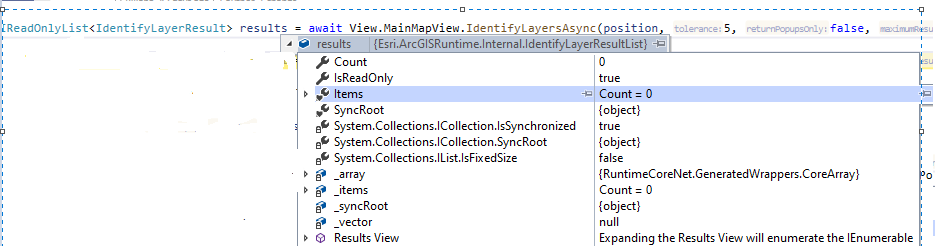

Hi
In my mapview if I load  a ArcGISVectorTiledLayer and when I select at any point on that layer then IdentifyLayersAsync always returns 0 items. Here is the sample code where the position is the selected coordinates. It works very well if I select any feature layer in my map view.
var results = View.MainMapView.IdentifyLayersAsync(position, 5, false, 1, _displayPopupCancellationTokenSource.Token);
Any leads would be helpful.
Thanks

Thank you for the advice about feature tiles. This is something we may use in the future, too. However, now we want to use vector tiles. Ideally, we would like to replicate in our application the same approach with a pop-up for vector tile layer as it is in ArcGIS Pro. We managed to display layers from Vector Tiles and have them associated with corresponding Feature Services on the backend of the application (similar as in ArcGIS Pro in attached image4). The problem is how to identify those Vector Tile layers when a user clicks somewhere in the map to know which Feature Services to request for pop-up (similar as in ArcGIS Pro in attached image5).
Is there no alternative to get the vector tiles layers loaded at the selected point? we just need the id of the vector tiles as we have all the layers available in the operational layers to fetch the desired information.
Also, we have found that for the vector tiled layer, the IsIdentityEnabled property is always false. Looks like the default behaviour which we can't change.
Thanks for your support in advance!

RomanBoros
Hi Nicholas
Thanks for your reply.
As I can understand from your suggested approach that while loading the vector layer I should also load the associated Feature layer with opacity 0 so that the feature layer won't display in the map view but it would be available in the result of IdentifyLayersAsync(). I think it can work. I need to discuss this with the team this approach and let's see.
