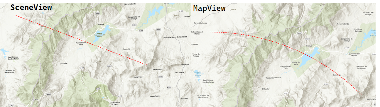

I want to create an arc in an SceneView. People told me I have to use EllipticArcSegment, and it works in MapView, but I can use it in SceneView. When I use EllipticArcSegment in ScenView I get a line not an arc. See the picture.

Nicholas-Furness
Hi. Thanks for following up in the Esri Community!
Unfortunately there is a bug in Runtime that means that true curves in a GraphicsOverlay require that the graphics overlay rendering mode is set to static. The default mode is dynamic.
This also impacts true curves in a feature layer backed by a mobile geodatabase, but that doesn't impact you here.
One alternative you could consider if you must display the GraphicsOverlay in dynamic mode is to densify the curve geometry and use the densified geometry for your graphic.
Hope this helps. I'll see how we can expose this information through the docs until we are able to fix it.

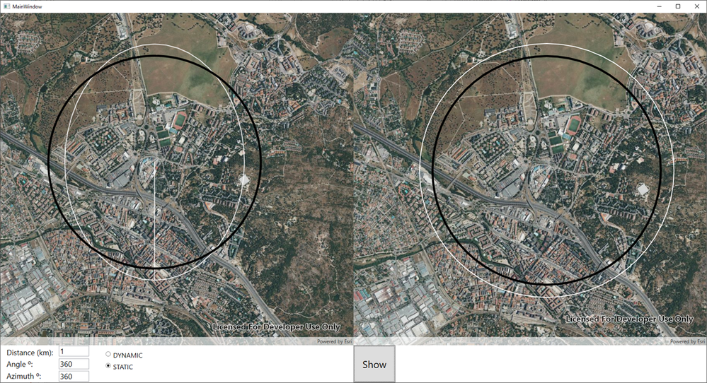

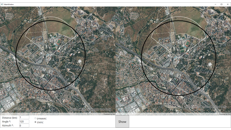

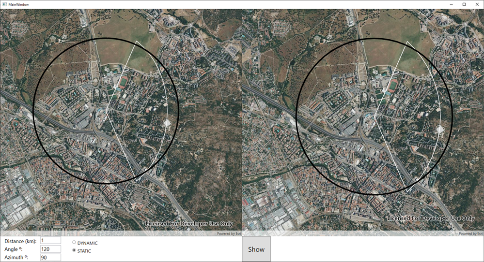

FranciscoLopez
Hi, so I was doing some test using the following the attached code and the results are very stranger, see the pictures.
I am using SceneView (Left picture) and MapView (Right picture). In the code, I draw a circle using GeodesicEllipseParameters and it make a perfect circle in the both Views. And I draw a Arc using EllipticArcSegment.CreateCircularEllipticArc where I cant make an arc that it follows the circle. In the pictures can show differents results.
The result is different using Dynamic or Static rendering.
I'd like to make a semi circle forms part of the main circle. So, How can I do it? The semi circle is defined by a radius, angle and azimuth.
