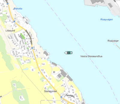

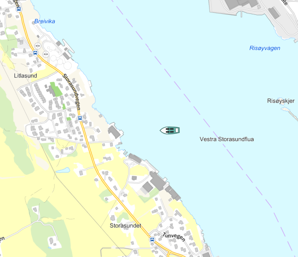

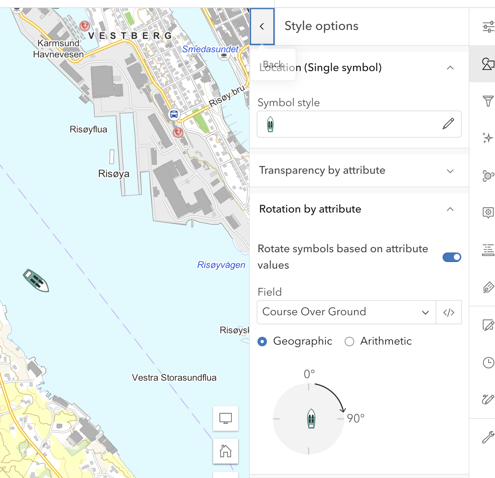

I am having issues with rotating symbols by attribute using ArcGIS Enterprise 11.1 and .sdk v. 200.7. The rotation works in my webmap in Portal, but fails in my client. Pictures below are showing the same object, where the client is unable to display it correctly.
Portal (This is the correct rotation)
Client (Incorrect rotation)
Is this a known bug? Have anybody else experienced the same issue? Any workarounds?

This is a hosted feature layer published from GeoEvent and runnning in a Big Spatiotemporal Data Store cluster. The symbology must therefore be configured in Portal as the symbology options for BSDS are limited. Do you know if it's a known bug?

  4. Have you tried switching from Geographic to Arithmetic to see if the results appear the same despite being the same field?
