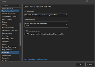

@JordanDuft I've had this same question before!
I usually would do metadata in Arc Pro first, then publish the service, and see what carries over to Online or Enterprise.
I know the metadata type you have set in Arc Pro determines a lot of what is carried over. I would suggest testing out different metadata types and how you want things to look in the web GIS to determine what to fill out.
Hope this helps!
