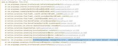

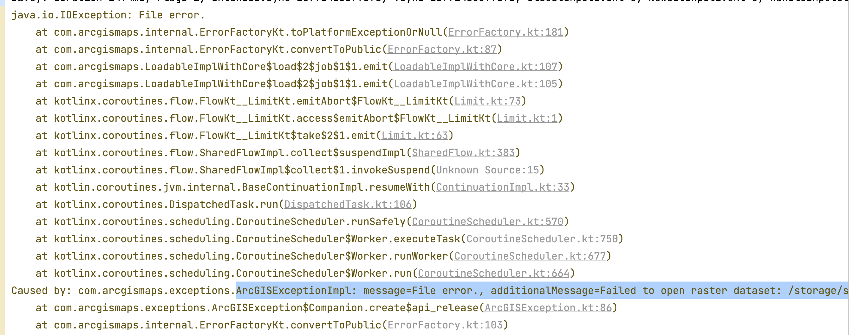

I try to  load local tif files with flowing codes (I do not set any license), but get errors, I make sure the path is ok, and the tif file can be  opened in other GIS software.
so how to load the local tif files?
my code:
val path = Environment.getExternalStorageDirectory().absolutePath + "/tiftest/tiftest/tiftest.tif"
           val raster = Raster.createWithPath(path)
           val rasterLayer = RasterLayer(raster)
           activity.lifecycleScope.launch {
             rasterLayer.load().onSuccess {
               map!!.operationalLayers.add(rasterLayer)
             }.onFailure {
               it.printStackTrace()
               Log.e("TAG", "Raster layer failed to load.")
error info :

Hello,
it looks like an issue with the tif file path on the device
Tried this in 100.15.0 and 200.1.0 and I am able to see the local raster .tif load fine.
Pushed the local TIF file using the below ADB command
./adb push XXX.tif /sdcard/Android/data/com.esri.arcgismaps.sample.displaydimensions/files
