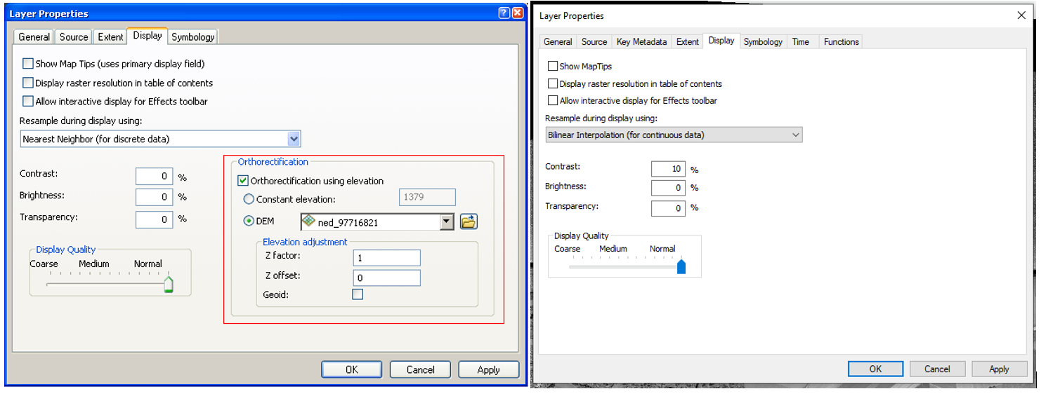

I'm working with Pleiades panchromatic images in ArcMap. When I load the DIM file my image appears correctly in my project. But I would like to verify that the RPC's are being taken into account and I would like to use a DEM to orthorectify the image.
If the RPC file is taken into account correctly I should have an orthorectify option in the layer proprieties of my image (display tab). If there is no RPC file found then this option should be grey-out. But for me, the option doesn't even exist.

For raster products such as Pleiades, please use the Geometric function.
You can also use the Orthorectify button from the Image Analyst window.
To access the Orthorecify button, first open the Image Analysis window.
Then in the Image Analysis window, highlight both your Pleiades layer and your DEM. Then click the Orthorectify button.
Now a new Orthorectified layer is in the map.  This is a virtual layer, so if you want to persist it, you will need to use the Export button (to the right of Orthorectify).

I read the documentation stating that if RPCs were correctly read for the image the orthorectification option should appear in the proprieties of the layer. I just wanted to make sure that the lack of this option doesn't mean that the rpc's aren't being read.
But if this doesn't signal a problem I will continue with orthorectification from the image analysis window. Thanks !

I believe the functionality has been removed, since the Geometric function\Orthorectify button are more accurate.  However the documentation may not have been updated with that change unfortunately.
If you are adding your Pleiades as a raster product, then it will have RPCs.
If you want to double check though, you can try the following:
1) Open up the raster layer properties of your raster (in the Table of Contents)
2) On the Functions tab, look for the Geometric function
3) Double click on the Geometric function. And click on the Geodata Transform button.
Here is all the geographic information for the raster product layer.
