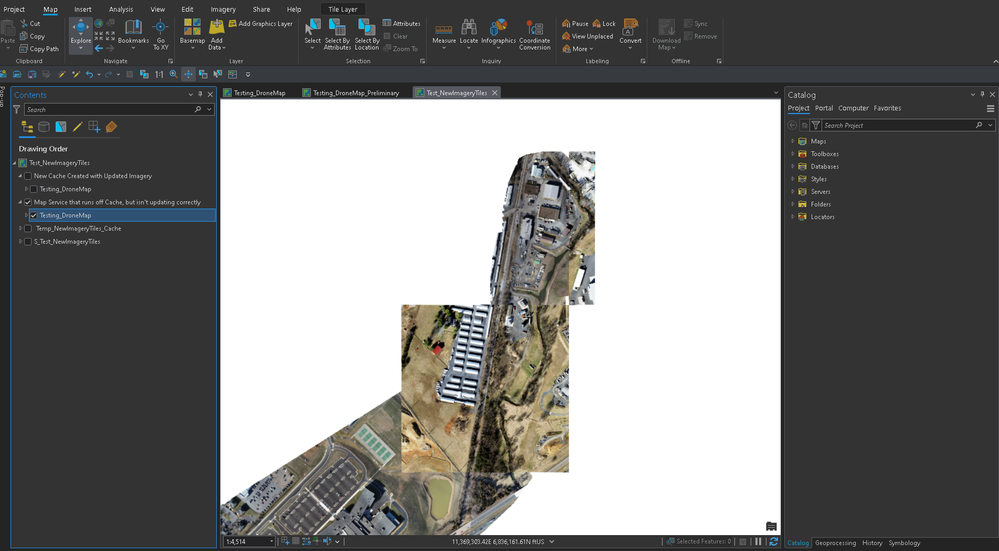

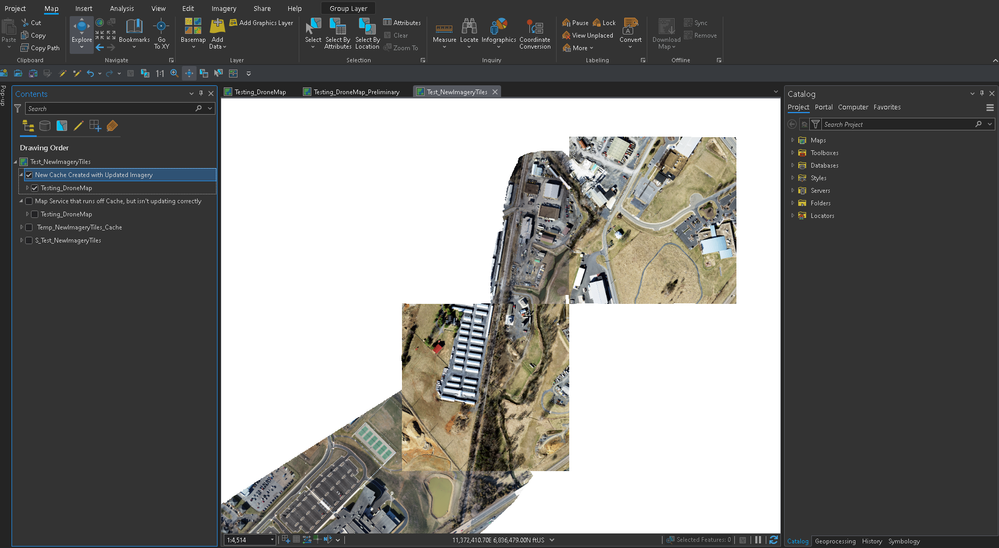

I had time to try out your workflow for creating an updated imagery cache and have mixed results. I'll list out my workflow below but in summary, I've been able to create an updated imagery cache with new areas of imagery. My problem is the original map service I created to run off the cache isn't displaying correctly. How do I get the map service to read the newly updated cache?
What I've Done
  • Originally, I created a map service from imagery for an area and cached it.
  • Then, I obtained new imagery I wanted to include in the original map service. I did your workflow and created a new cache for the new areas.
  • Then I imported the new cache tiles into the original map service's cache.
  • The results I've had are shown in the two screenshots I've attached. Basically, the updated cache when pulled into ArcGIS Pro displays correctly, with the new tiles added and is exactly what I want. However, when I look at the map service in Pro or AGOL that runs off that same cache, it doesn't display the tiles correctly. It has missing sections and is patchy.
  • Do I need to overwrite the original service to get it to update and load correctly?
    • I've already restarted the service.
    • And I've verified it's running off the correct cache.
Thank you for your help!
JonUpdated Map Service Screenshot, Not displaying correctly with missing imagery sectionsUpdated Map Service Screenshot, Not displaying correctly with missing imagery sectionsUpdated Cache Screenshot loading everything correctly.Updated Cache Screenshot loading everything correctly.

GordonSumerling
@JonM32 From reading your process you have done everything correctly as it displays correctly in ArcGIS Pro. I am thinking you may need to Refresh the service as in this document. https://developers.arcgis.com/rest/services-reference/enterprise/refreshservice.htm
Additionally, you may need to refresh the REST cache as per this document
https://developers.arcgis.com/rest/enterprise-administration/server/handlersrestcacheclear.htm
JonM32
by
@GordonSumerling
Thanks for the additional tips. I tried them out and haven't had much success in resolving my issues. I'm going to open a support ticket next week and see what they suggest.
I feel like it's something I missed on my end so I'll mark this as the solution, but can update the post once I know whats up.
Thanks!
