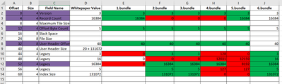

Hi @FredericPoliart_EsriAU
I am reaching out with an inquiry concerning the structure of ArcGIS .BUNDLE files as outlined in the white paper available here: CompactCacheV2. (https://github.com/Esri/raster-tiles-compactcache/blob/master/CompactCacheV2.md)
According to the document, the legacy fields in the file are expected to consistently align with the "Whitepaper Value" specifications. However, upon examining some sample .BUNDLE files, I've noticed discrepancies between the documented values and those present in the samples, as illustrated in the attached capture.
Could you provide clarifications on these differences? For accurate processing and identification of .BUNDLE files, it is crucial for me to have precise information regarding these fields. I appreciate your attention to this matter and look forward to your assistance.
Thank you very much for your support!
