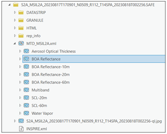

I'm trying to follow the solar park classification deep learning model (Use the model—ArcGIS pretrained models | Documentation), and I am wondering how to download or access the sentinel-2 imagery that the model depends on. It seems like there's a specific "Bottom of Atmosphere" reflectance layer to use, and I have to import the ".SAFE" files to create the mosaic. However, I don't see any instructions on how to download this package of files. When I try to download Sentinel-2 data generally, I can grab RGB tifs, but it's not clear to me how to get the package of data the instructions reference:

Hi @SaffiaHossainzadeh1 you can download Sentinel-2 Imagery from https://browser.dataspace.copernicus.eu/
Once downloaded you can extract the files to the desired location and you be provided with the folder structure and raster products that we see in the above screen shot

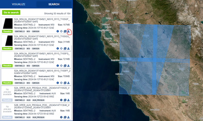

SaffiaHossainzadeh1
Thank you very much! That worked! Just to clarify with a few more details if anyone else happens upon this post, once you sign up/login for the copernicus browser linked to above, you can toggle into the search tab to actually download the data in the format that is needed for the deep learning package.
