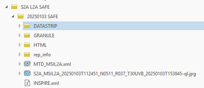

JackFilbrandt
Hi @CodyBenkelman
I am trying to load Sentinel2 data into a Mosaic Dataset so I can build a multidimensional raster for temporal spectral analysis and classification. I'm familiar with loading and processing Landsat data: I have run through https://learn.arcgis.com/en/projects/get-started-with-multidimensional-multispectral-imagery/ Julia Lenhardt's tutorial and have managed to create and process Landsat data I downloaded for my own study over part of SW UK from creating a mosaic dataset to building a multidimensional raster of the multiband satellite images, converting to CRF and subsetting the time cube in the Data Management tab. The results are good but I want to use the Sentinel 2 L2A data to achieve higher resolution.
I've located the Usage Guide for Sentinel2 Geoprocessing Tool for creating mosaic datasets (January 2025) through links I found above - many thanks for that. I've downloaded the zip file and installed the Sentinel2 tool. I have also downloaded a Sentinel2 L2A scene over part of SW England  for January 3 2025 in SAFE format along with all the directories. I run the Sentinel2 tool in Geoprocessing and select an existing gdb for output and select the appropriate Dataset type (Sentinel-2 L2A) with Multispectral so i can see all 13 bands. The tool returns without failing but with a warning that the nominated gdb exists. See attached document: Sentinel2.txt
Unfortunately, while Overviews of the scene I am processing are created and appear in my Folders on Catalog with all 13 bands, the Mosaic dataset does not appear in the Contents pane and isn't anywhere to be found.

S2 L2A SAFE mode - only difference between this and the usual folder situation is that an AUX DATA folder is located in the GRANULE folder and not alongside DATASTRIP AND GRANULE.

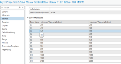

I made progress, though I have a confession to make: I forgot to make sure I refreshed my folders after running the Sentinel2 tool. I should have realised when I saw the Overviews tif files in my Catalog folders. When I refreshed the .gdb, the Mosaic dataset  showed up – I initially ran with the Multispectral option only and the Define and Build Overview checked. And of course the Boundary, Footprint and Images didn’t show as I hadn’t added the Mosaic to the Contents pane for the current map! I’m working on my own and I simply forgot these two steps – I suppose I was expecting the Boundary etc to show up in the Contents pane like it does for the Create Mosaic Dataset Geoprocessing tool. Would be great if Sentinel2 did the same!

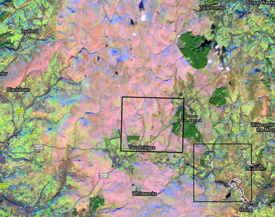

I also learned that the name of the top directory should not be changed once downloaded from the Copernicus Server (the name on my dataset was only 65 letters long - so ok for length) - I had initially changed the name of the top directory manually when I dropped it into my C-drive folders. I found out when I looked at the image in the map view window. A grid of blue, yellow, black and white squares showed up when I zoomed in (350 by 350 m). I initially tried to reBuild Pyramids and Statistics and Build Overviews in Geoprocessing. The statistics worked by Build Overviews failed aa the process couldn’t find the directories/files it was looking for. Strangely, Sentinel2 didn’t complain on the first run even though I had Define and Build Overview checked.
So, I changed the name back to what it originally was and now I have a Sentinel2 image on my map. Mosaic Dataset properties show that all 13 bands have been read in.
And I can run Build Multidimensional Info successfully – the slider bar for selecting time shows up at the top of the map view.
I also noted that the default Mosaic processing template is set to Agriculture with DRA. That left me with only three of the bands (2, 8A and 11). I selected S2MSI2A in Mosaic Properties > Processing Templates to get all 13.
