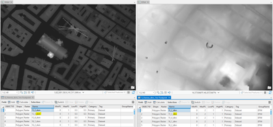

 Here are the two source MDs side by side: At left, the DSM (central Vienna, Stephansdom area); at right, the DTM with the rasters listed below in TableView. In the Catalog window, it looks like this:

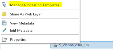

In this Catalog view, right-click your DSM layer and select the Manage Processing Templates entry:

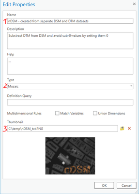

This will display the Edit Properties form—see the important settings noted in red:
  1.  This is the name displayed later in the UI for selecting this template—choose one that is unique and self-explanatory.
  2.  The function template you create will apply to the mosaic as such—this is important.
  3.  Think about creating and adding a visual for the function—not mandatory, though—then click OK to confirm.

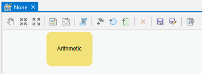

The (still) empty Function Editor appears—time to add the functions. Open the Raster Functions pane:
In the Search box of the Raster Functions pane, enter "Arith" to quickly find the Arithmetic function. Drag it into the Function Editor:
It now looks like this:

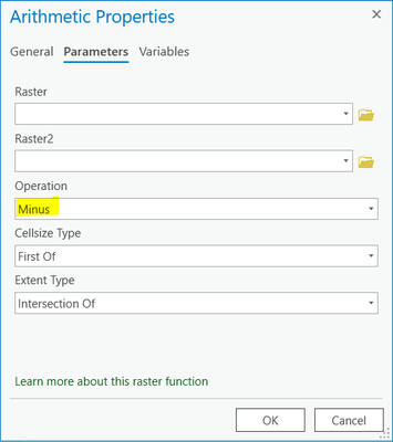

Double-click the Arithmetic function to open the settings, and fill in accordingly:
  1.  No need to do something here—this references the current mosaic.
  2.  Navigate to your DTM mosaic here and select it.
  3.  This is the place to select Minus as the mathematical operator— leave the other defaults and click OK.

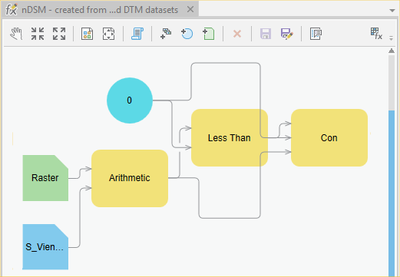

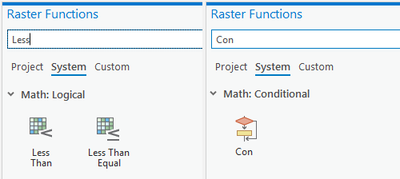

Open the Raster Functions pane again, and first search for "Less", then for "Con", and add both to the Function Editor:

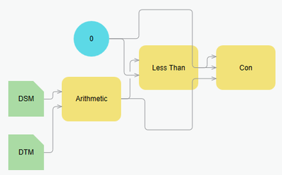

Once they are added, you will need to make the necessary connections. Start with connecting the output of the Arithmetic function with the Less Than function. You will want the output of the Arithmetic function to be the first raster in the Less Than function:
As Raster2, the second raster, is the one to check against with the Less Than function, you need a raster that has only 0 values.
You get this by creating it in the Function Editor, using the Add Constant button:
As this is by default 0, you only have to connect this 0 raster to Raster2 of the Less Than function:
Now, you'll have to connect the three inputs that the Con function needs. These are called Raster, True Raster, and False Raster—and those three have to be connected like this:
  • Raster is the output of the Less Than function, which is Boolean (either true or false).
  • True Raster is what needs to be done when Less Than has returned True, so this needs to be connected to the 0 raster (again).
  • False Raster is what needs to be added when Less Than has returned False. The output of the Arithmetic function needs to be connected here (again).
Here's how it looks once you are done connecting:

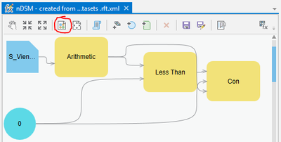

You can clean it up using the Auto Layout button, then it should look like this:
Save and close and reopen once: Now you'll also see the reference (shown in green) to the DSM mosaic itself, as mentioned above:
