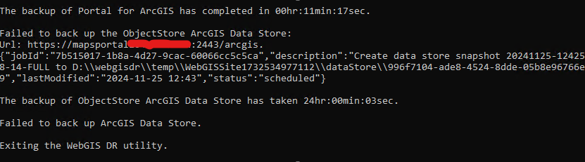

Hello,
Testing the upgrade from ArcGIS Enterprise 11.3 running on Windows Server 2022 to 11.4 and I am facing an issue after having migrated my tileCache datastore to objectStore using the `MigrateSceneServices` utility.
https://enterprise.arcgis.com/en/server/latest/publish-services/windows/migrate-scene-services-utili...
Here is the workflow:
- From 11.3, upgrade to 11.4 OK
- Export webgisdr backup OK
- Import webgisdr backup OK
- Upgrade scene services using `MigrateSceneServices` utility: OK
- Update the webgisdr.properties to INCLUDE_OBJECT_STORE_CACHES = true and INCLUDE_SCENE_TILES_CACHES = false
- Run the webgisdr export
It systematically fails after 24 hours... (before it was done in 1 hour !):
The tileCache was about 29 Go and composed of 20 scene services (mainly meshes).
Anybody else faced the same issue ?

Once migrated, can you check the size of the object store folder (for example C:\arcgisdatastore\ozonedata); is it also 29GB? When you are waiting for the backup to be created, can you check whether the size of the temporary folder for the object store backup is growing in size, and how fast? It'll be a path under your SHARED_LOCATION path, with a guid. You'll need to look in each folder with the guid to see if its the relational or object store backup.

I have the intuition that there are so many files to copy that it takes ages but that is just a feeling...
Only retrieving the size of the folder the 'ozonedata' took couple of hours as there are so many files. Small comparison:
- before migration 'nosqldata' folder:  27.7 GB, 265 files, 9 folders
- after migration 'ozonedata' folder:   21.4 GB, 2 353 27 files, 81 folders
When I am waiting for the backup to be made, I can tell that the 'local' object store backup works (ie: the first backup which is done in the configured backup location). Using the ArcGIS Datastore utility command 'listbackups', I can tell it is running during around 9 hours (!), then I can see the backup listed as SUCCESS using this utility. Finally, it starts backuping over to the SHARED_LOCATION but the copy of the object store is very slow: it is growing super slowy.
In the end, I think it only fails because it reached the hard coded time out value of 24 hours. It is copying slowly but surely but is very inefficient due to the large number of files. When it fails after 24 hours, the objectStore backup folder is around 9 Go only so there is still a lot to copy remaining.
I suspected a network drive performance issue so I moved the SHARED_LOCATION folder and BACKUP folders of the webgisdr to a local drive on the machine (it is a base deployment for testing purpose) and it failed as well. I am now requesting a new drive with more IO to see if it helps..
