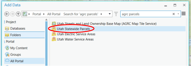

On the left hand side of the Add Data dialog box, look under the Portal category and choose the All Portal option:
screenshot
In the search box, type in “AGRC Parcels”
screenshot
Choose the newly created “Utah Statewide Parcels” Feature Layer and then click on Select:

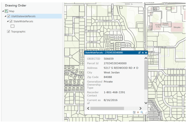

Because there are hundreds of thousands of Parcels in the State of Utah and this layer contains them all, it is a good idea to zoom in to a specified location in order to minimize drawing time. While this is different than how it used to be (each county was once its own layer), you can now utilize the entire state at one time which is helpful when your data spans across counties.
After it is loaded, you can treat it like you would treat your regular data:
gis5
