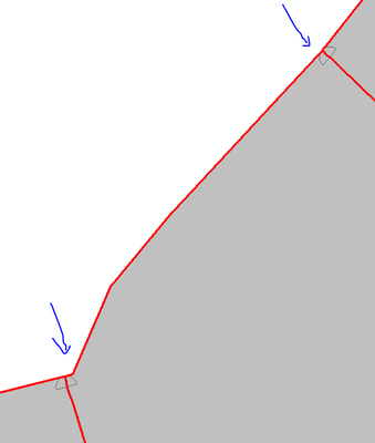

Hello. I'm trying to split small polygons and merge them into the nearest _large polygons. With the Eliminate tool, the small polygons are merged into the large polygons but the boundaries between the two polygons look strange. Is there a way to do this automatically anyway? The feature class has thousands of small polygons that cannot be done manually.
After using Eliminate tool:

This picture showing how my issue with small polygons was solved. Just want to share with others if they have the same issue.
MaryamPanji
Hi Jim,
Yes by enabling 'create multipart features' I don't have to use the dissolve tool. Thanks for that.
Simplify has been ticked and I got those jaggies. About using background polygon, I'm a bit confused, cause I have polygons all over the country.
Regarding the use of background polygons, I am a little confused because I have polygons around the country. I'm going to send you a part of the layer that has many geometry issues and the model builder I'm using for doing the whole process.
