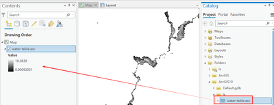

qichitu
I have the same problems. I just drag the .asc file from the Catalog to the Contents, and it is displayed as raster. You can save the raster by context menu.
