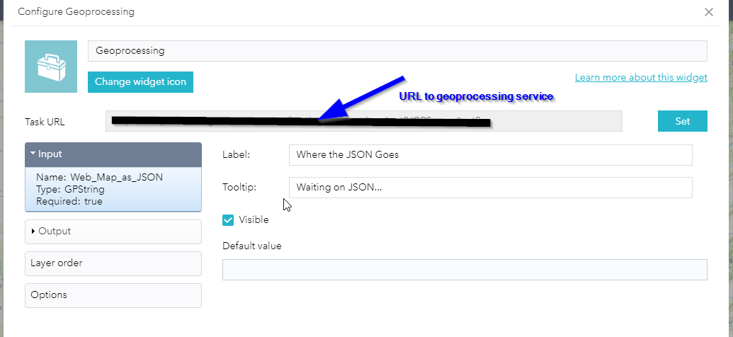

There is no simple way of generating some sample JSON describing your web map that you could use to test your script. So after publishing a script as a geoprocessing service that takes <webmap_as_json> as an argument, how do I pass the json ?
I can hook Web AppBuilder's Geoprocessing widget into my geoprocessing services but it's needing that JSON to feed on.
So I'm inclined to think I'm headed down the wrong path.
Questions:
  1. Which widget, if any, can call geoprocessing services and pass along the JSON?
  2. Is a "staged layout template" just a PAGX file sitting in a folder registered with my hosting server?
