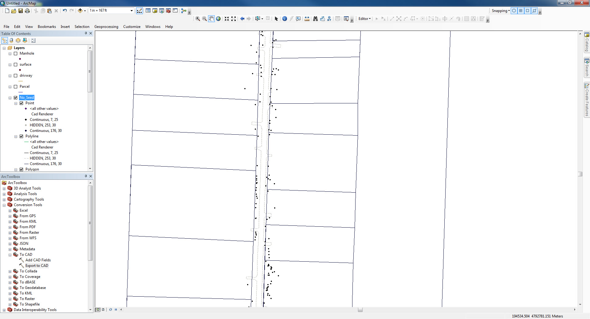

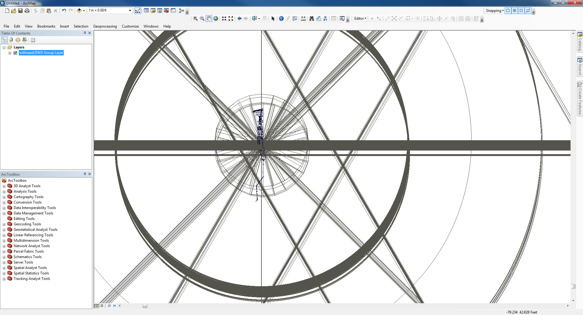

JerF
Hi Cheryl,
I am having the same issue as you currently! I have been trying to follow the steps you have outlined but I am having trouble understanding what to do. Can you please go into more detail? Whenever I export to cad with a seed file all of the block inserts get layered one on top of each other. I have attached screen captures. This is when I export with the seed fileThis is without a seed file
