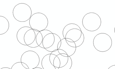

I'm working with ArcMap 10.5 and I have a land cover layer and some circular buffers. I need to know what land covers  are inside the buffers, as well as calculate the area of those separetely for each buffer.

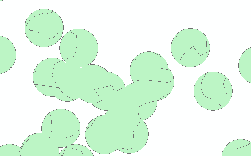

I did a clip of my buffers and land cover layer, but what I obtained was a layer where the buffers were merged depending on the land cover.
These are the buffers
This is the clip I did. As you can see the buffers that overlaped are now merged. I want them to be separated features so I can calculate the area for each one of them. I will take care of the double sums later.
Thanks I hope I was clear.

Tabulate intersection https://pro.arcgis.com/en/pro-app/latest/tool-reference/analysis/tabulate-intersection.htm would achieve the end goal without needing this clipping step.

You could join https://pro.arcgis.com/en/pro-app/latest/tool-reference/data-management/add-join.htm the buffers to the tabulate intersection table by matching field.
If you need to have your data clipped to each buffer for some reason, then Intersect https://pro.arcgis.com/en/pro-app/latest/tool-reference/analysis/intersect.htm might do this for you without merging the geometries.
