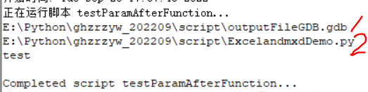

The messages printed out only contain param 1 and 2.
Param 3 and 4 are NoneType values based on my further test, even though I provided some values as input. This happens regardless of the parameter data types configured with the script tool.
