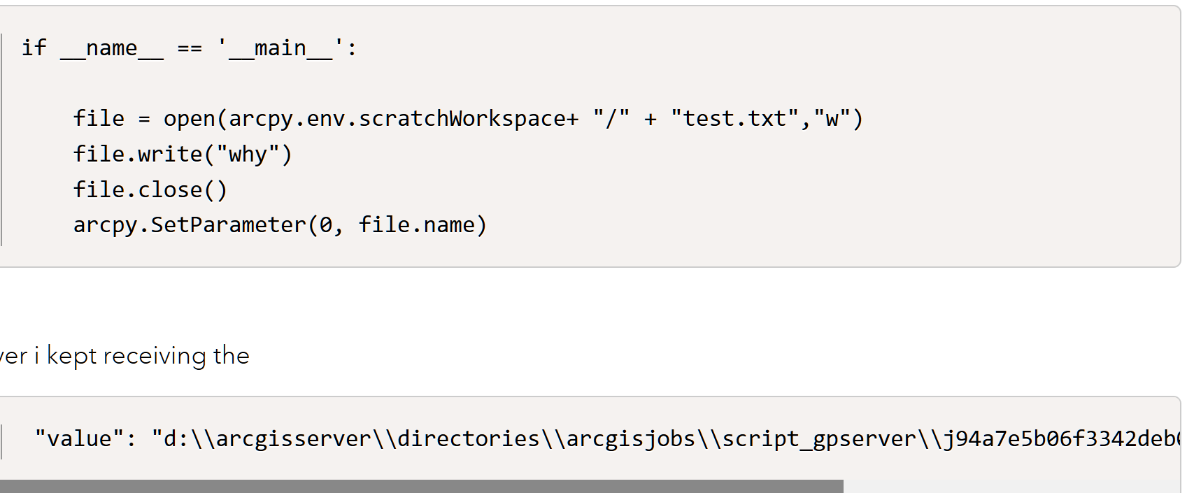

The post here shows it should be my arcgisjobs dir right?  https://community.esri.com/t5/python-questions/geoprocessing-service-to-return-a-file/td-p/522062   I remember seeing this happen in the past I think.

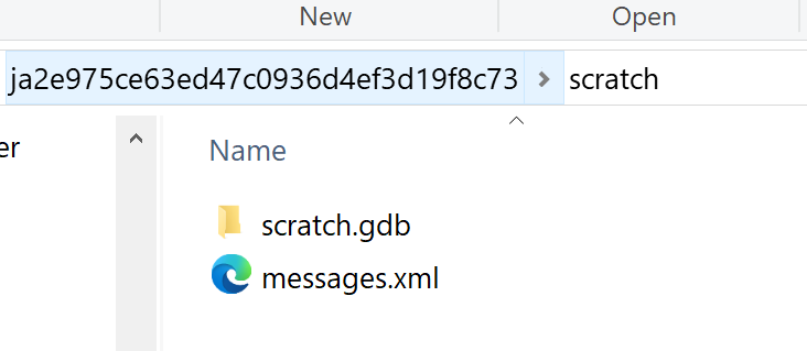

I am even seeing it create the jobs dir with a scratch folder in the arcgisjobs folder and even a scratch GDB but it does not use it.  I can find no way in script to find this jobs dir either?
