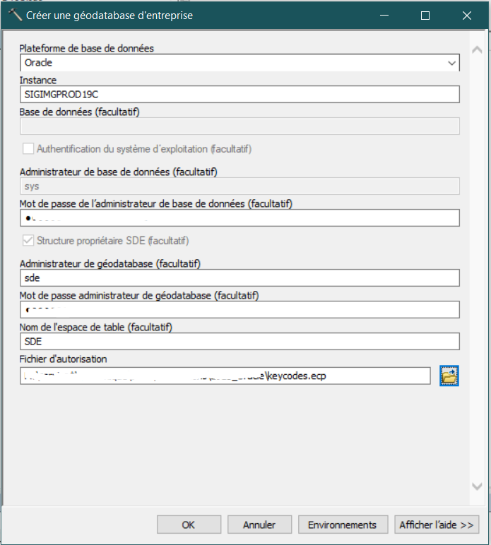

But when I use the tool "Create Enterprise Geodatabase", I've got an error :
Failed to connect to the specified DBMS instance (Échec d'accès au serveur DBMS)
