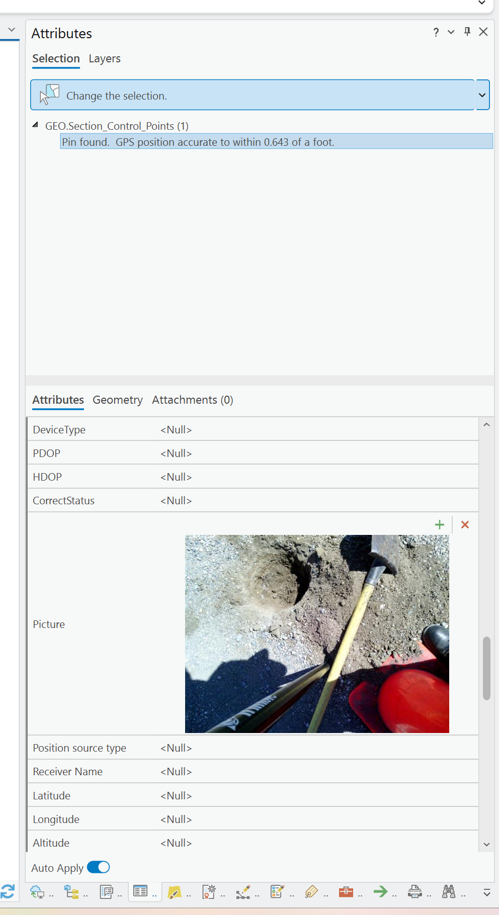

I have a geodatabase feauture class that we have been using for years.  We used to collect an image into a raster field for each feature in the Enterprise Geodatabase (SQL Server).  With our new field maps collecton process I cannot figure out how to collect into the raster field, so we have enabled attachments.  I would like to now move any existing pictures from the raster field into an attachment.
Here is an example:
I need guidance/advice!

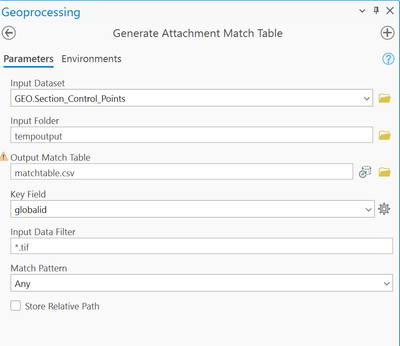

The code allowed me to create a folder with all the attachments, but I could not get the code to add the rasters as attachments to work, but I was able to manually use the geoprocessing tool "Generate Attachment Table" like this:

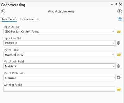

and then the "Add Attachments" tool, like this:
It all worked!  Thanks.
