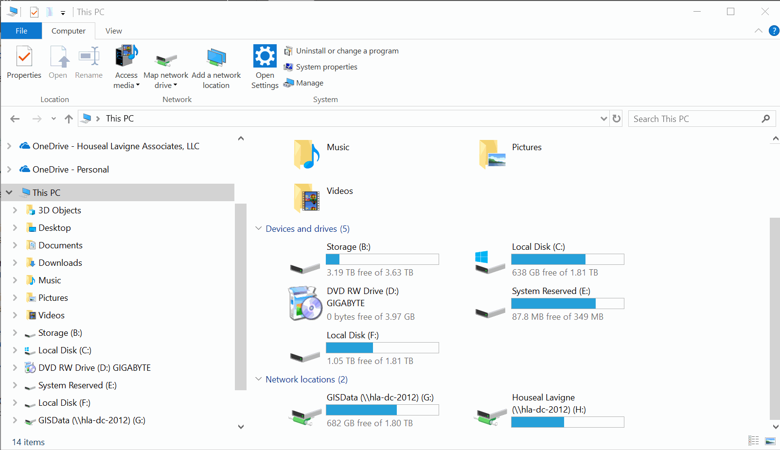

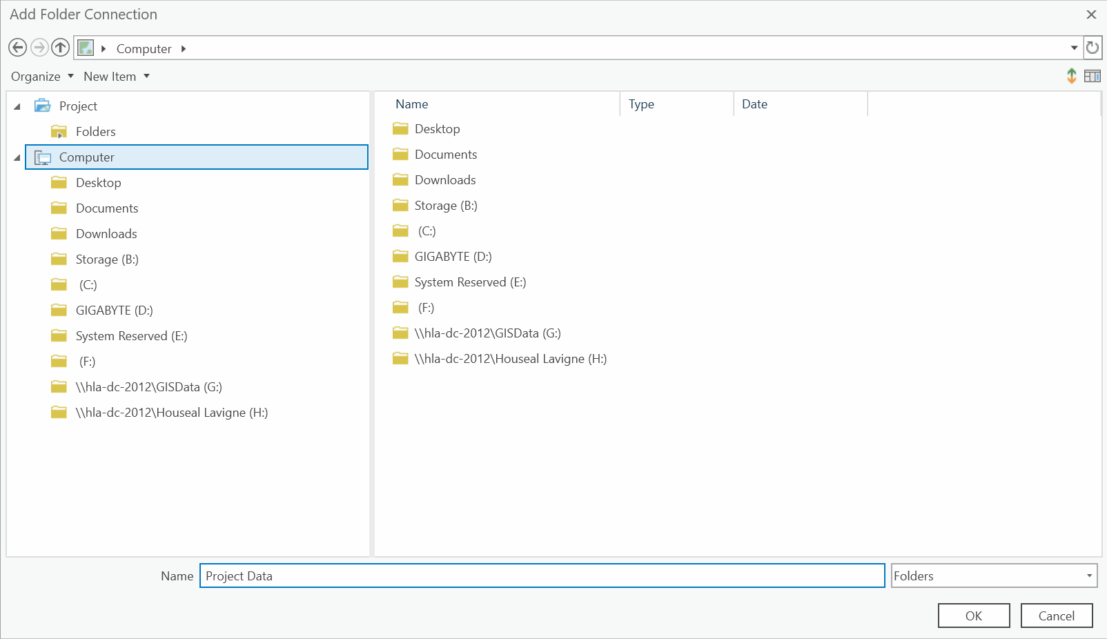

DevinLavigne
I just posted two animated Gifs of me browsing directories in Pro on another thread and thought I should post them here too. Something is either not working in Pro, or I'm missing a necessary network protocol on my server adapter to make this function as one would expect.
1. Browsing a directory in ArcGIS Pro
2. Browsing the same directory in Windows

We get the exact same experience here. We're moving to a DFSR path to a local server on the network but it doesn't look like that resolves it either. It seems there's something with Pro which slows down browsing and it's noticeably worse than ArcCatalog/Map.
