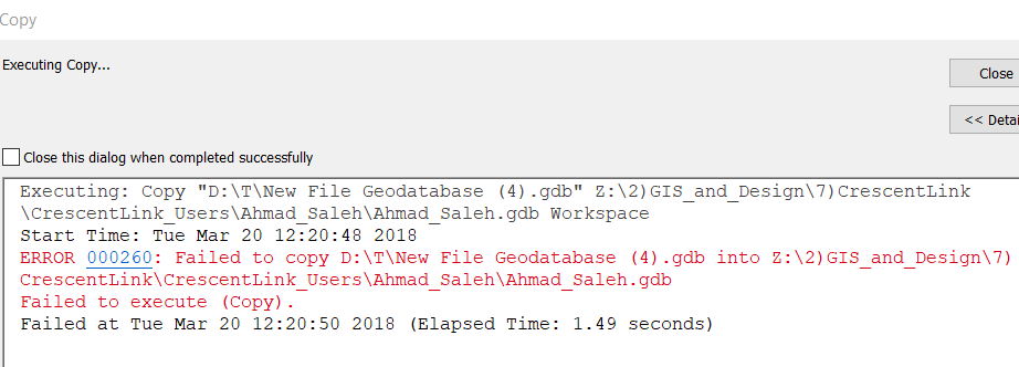

I am trying to use the tool "Copy (Data Management)" from ArcMAP 10.5.0 to copy a Geodatabase from local drive (D:) to a network drive (Z:). and every time I  got the following error:
ERROR 000260: Failed to copy D:\T\New File Geodatabase (4).gdb into Z:\2)GIS_and_Design\7)CrescentLink\CrescentLink_Users\Ahmad_Saleh\Ahmad_Saleh.gdb
Failed to execute (Copy).

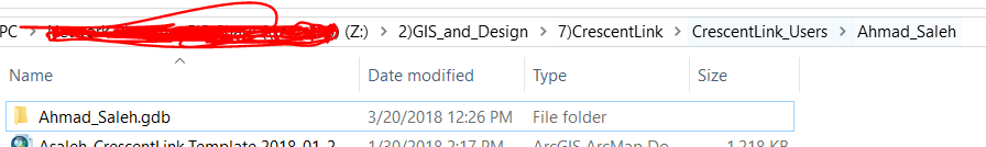

But the unusual thing is  when I go to the destination folder I am able to located  this Geodatabase  and also I can connect to it  and see or edit  the data inside, everything looks normal!.
The tool worked and copied the GDB to this location but it also throw  the previous error!.
