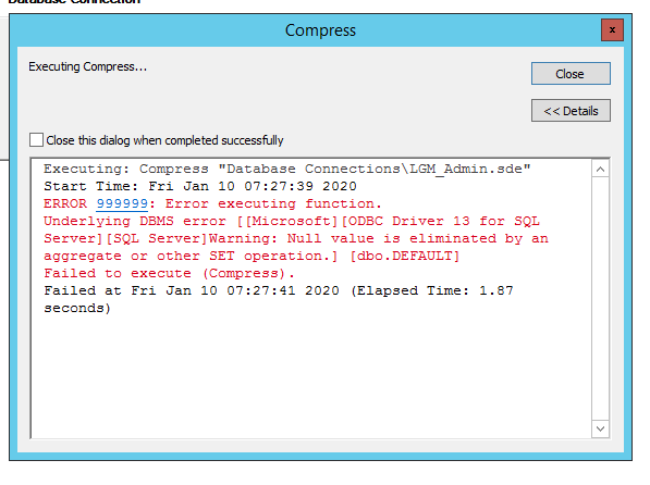

When trying to run a compress this morning I got the following error:
The first time I was trying to compress there were no versions and no connections. In other attempts to compress I had re-added all the versions and there were connections to the database and I got the same error.
After doing a little research, I found that re-building indexes seemed to fix most errors people had when compressing. I tried to re-build indexes for the entire geodatabase and still got the error above when trying to compress.
Is there anything else I can try?
More information:
It is a 10.5.1 geodatabase running on SQL Sever 2014.
HeatherScroggins
So I found the issue.
We have a tool that creates ID automatically and I had forgotten to turn it off before renaming two feature classes this morning. So the tool was still looking for the old registry IDs and throwing errors.

HeatherScroggins
It has a compress_status of 'FAILURE -51'
