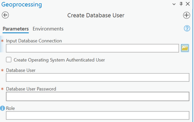

Are you saying that if I want a schema named 'COMMON' (i.e. 'COMMON.TBL1), then I need to create a Database user named 'COMMON', and then anybody who needs to write to COMMON schema has to share the db credentials (user name and password) or made sde connection?  This all given there is a COMMON schema in the db (which I have created).  Let me know.  Thx.
George_Thompson
Esri Notable Contributor
Yes, you are correct @TylerT . You would create a user (with matching schema) and load data as that user. Using the GP tool will make sure that user has the correct permissions, etc.
You "could" share the connection file for the COMMON user if other needs to load data in that schema.
