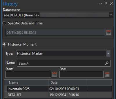

Hello, I'm trying to create a historical marker in my enterprise geodatabase on a dataset containing branch-versioned feature classes (from a Utility Network).
However, I can't find any documentation regarding the availability of this functionality with branch versioning.

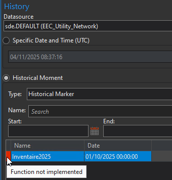

When I access the data directly from the .sde file, I can create a historical marker, but I don't see anything in ArcGIS Pro when I access the same data via the feature service.
Furthermore, when I access the data from the feature service, an error occurs when saving the historical marker.
Upon checking the database, I can't find the sde.gdb_historicalmarkers table.
Is it possible to create markers on branch-versioned data and access them via the feature service?

Branch versioned data currently only supports accessing a specific date and time.
I am not able to select the Historical Moment radio button like you are showing - it is not enabled in the UI.
There is an existing enhancement request you can contact support services to get added to. Please give a justification and explain your workflow in detail where being able to access a historical moment/marker would be beneficial to your organization.
ENH-000128422 - Support working with historical markers for feature services with the version management capability.

Thank you, I will contact support to be added to the enhancement request.
