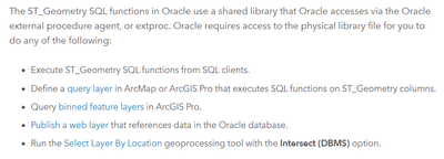

The ArcGIS Pro manual (see https://pro.arcgis.com/en/pro-app/2.9/help/data/geodatabases/manage-oracle/configure-oracle-extproc....) says :
But even if st_shapelib and extproc are not configured at all, the ArcGIS Server services create extproc processes on the database server. How is this to be explained ...

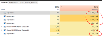

... and why do they grow so rapidly during operation. In our customer’s environment ArcGIS Server produces extproc processes of exorbitant size which finally crash the database server:
Any idea (helping to understand) would be great!

Can you provide information about your workflow and what your customer is doing? Which of the operation(s) listed in the help are they performing when you are experiencing this behavior?

My guess is that one or more of their feature services / web maps are performing 2 or 4. If you have a staging environment you should be able isolate the issue to a specific service or map that is behaving badly. If you are unable to reproduce using just the feature services, then one or more of your users may be performing items 1, 3, and/or 5.
