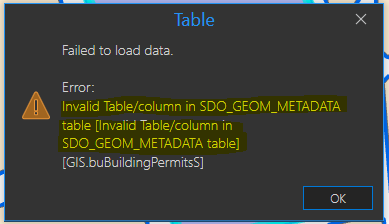

Hi,
 Environment: Oracle 11g R2
 Enterprise geodatabase version: 10.7.1 with SDO (Spatial Data Object configuration for storage)
Scenario:
 Restoring SDE, Owner Schemas done using impdp from dmp files of the Schemas
 When opening feature class attribute table on Arcgis Pro v3.1.2
an error occured "invalid Table/column in SDO_GEOM_METADATA table [invalid table/column in SDO_GEOM_METADATA table] "
Please advice if there is any required change needed on MDSYS tables and what is it?

Hello @RedaAli as your restored Geodatabase does appear to function with ArcMAP 10.7.1, then that suggests the restore may have completed correctly. But unfortunately Oracle 11g R2 is too old for use with ArcGIS Pro 3.1.2 and so is not a supported option.
ArcGIS 11.1 and ArcGIS Pro 3.1 requirements for Oracle—ArcGIS Enterprise | Documentation for ArcGIS ...
If you want to access your Geodatabase from both ArcGIS Pro 3.1.2 and ArcMAP 10.7.1 then you need to use Oracle 19c
Oracle database requirements for ArcGIS 10.7.x and ArcGIS Pro 2.3 and 2.4—System Requirements | Docu...

Please, open a ticket with Esri Technical Support to investigate this further.
There are many reasons this can happen, including invalid geometries or a bad spatial index.

When I opened the database connection from ArcMap v10.7.1, the issue resolved for all layers.

Thanks for your clarifications @ChrisUnderwood  , it might be an issue with computability of ArcGIS Pro v3.1.2 with oracle 11.2.0.4.
Could you please send the arcgispro v3.1.2 compatibility with Oracle DB versions list?
