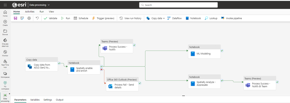

Fabric’s Data Factory allows creation of data pipelines to build complex ETL workflows.  It includes a number of pre-defined activities, for instance to copy data from cloud warehouses into OneLake.  It also includes the ability to bring in Spark notebooks as part of the workflow – and this is how we can leverage GeoAnalytics for Fabric!

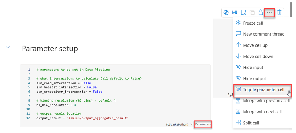

Within a notebook.  Inside the Fabric notebook, you need a cell that defines the parameters for the notebook.  This looks like any other cell, but has been flagged as a “parameter cell.”  In the examples below, we have a set of parameters that can be used to identify what analyses will be performed (i.e., identify pipeline intersections with roads, critical habitats, or competitor pipelines), what resolution the aggregated results will be returned in, and where the output result file will be saved.
Each of these parameters has a default value set, so if no updates are made in the Data pipeline, the notebook will still run and will rely on these default values.  But, if a user updates them in the Data pipeline, the notebook will update the flow through the analysis.

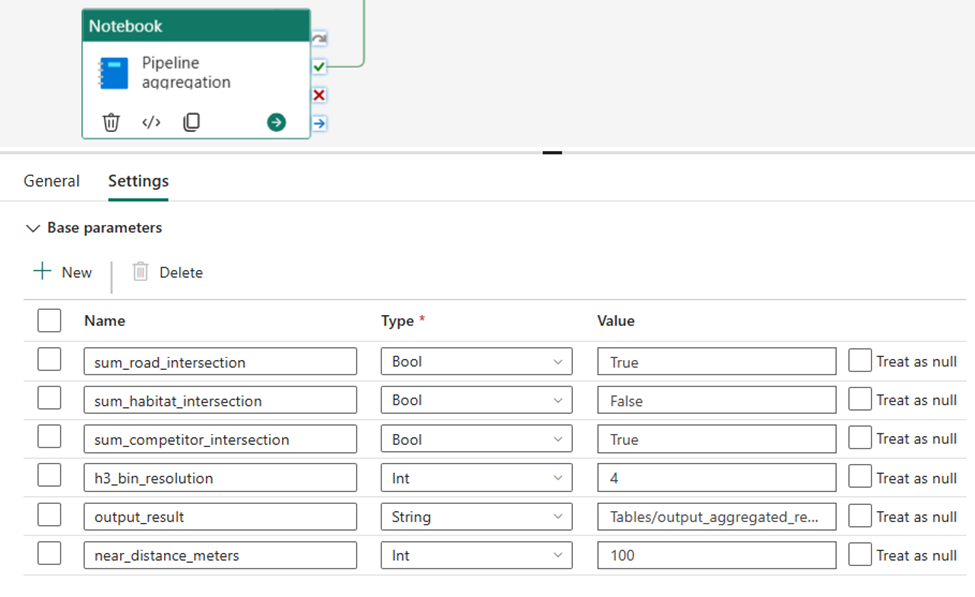

Within the Data pipeline. Let’s look at how these appear within the Data pipeline for a user to update their values.  Within the Data pipeline, once a notebook has been added to the canvas as part of a workflow, it can be selected to update its settings.  Under “Settings” for the notebook new values can be entered to update the parameters.
In the example below, we’re setting the notebook so that when it runs it will calculate the pipeline intersections with roads and the intersections with competitor pipelines, but not the intersections with critical habitats.  It uses h3 bins of resolution 4, a “near distance” (for identifying roads or competitor pipelines that are within this distance of interest) of 100 meters, and will return the aggregated output to a file called “output_aggregated_results.”
Now that the settings are updated, when the pipeline is run, it will swap these values into the notebook to replace the default values.  Anywhere these values are used in the notebook will reflect the new values and run accordingly.  From the Data pipeline all the user needs to know is what the parameters are that they can edit.

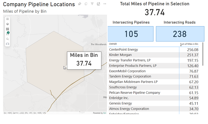

In this example, when the notebook is run as part of the Data pipeline, it returns results into OneLake that we can use in a Power BI dashboard to analyze our oil and gas pipelines relative to nearby infrastructure.
