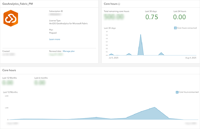

There are two easy ways to track your usage.  First, you can use the GeoAnalytics for Fabric dashboard associated with your account to view the overall usage and graphically explore your past usage.  Note that this dashboard isn’t updated immediately as the data is collected and there may be a short lag between completing a process and the dashboard being updated.

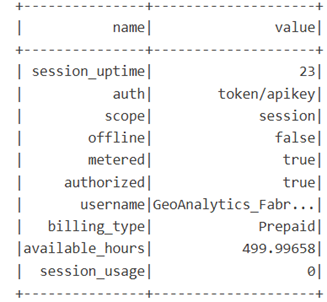

auth_info()  lists the authorization information for the authorized user.  That includes user name, session time, total core-hours available, and the current session usage.  Session usage time is reported in core-milliseconds.
geoanalytics_fabric.auth_info().show() will return a list like this:

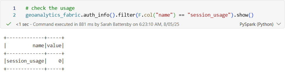

Before I run any operations, I can check the number of core-milliseconds used (reporting via auth_info() or usage() is always in core-milliseconds, even though the overall unit for GeoAnalytics for Fabric is in core-hours).

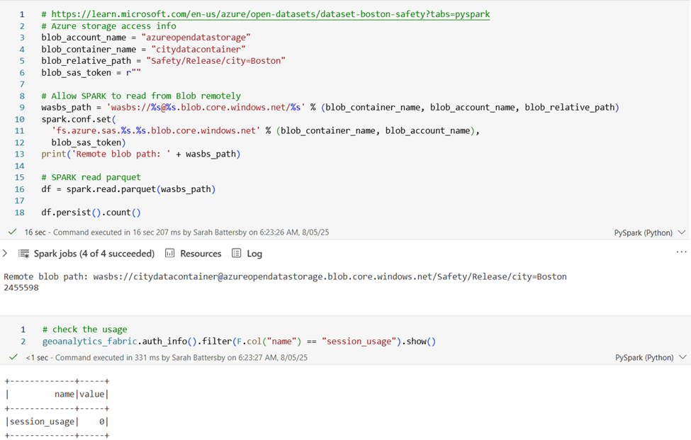

As I complete operations, I can look again to see how many core-hours have been used.  In this case, I started at 0.  After I read in a parquet file from the Azure open datasets (city of Boston 311 public service calls), the usage is still 0 – because reading parquet files is a Spark function, not a GeoAnalytics for Fabric-specific function.

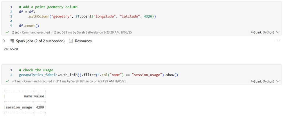

After using the ST_Point function from GeoAnalytics for Fabric to create a point geometry from the latitude and longitude fields in the parquet, the usage is now 4229 core-milliseconds.  That translates to ~0.0011 core-hour. Not very much.

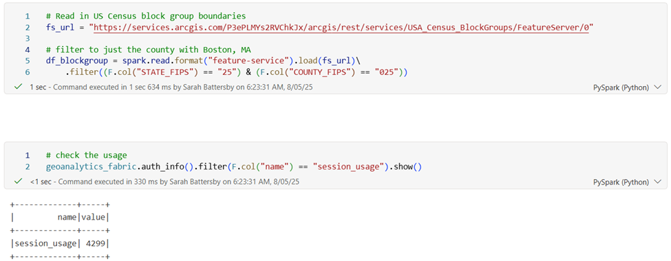

On the other hand, if I read in an Esri feature service, we would expect that the session usage to increase since reading feature services is a GeoAnalytics for Fabric-specific functionality.  Let’s see what happens:
After reading the feature service the session usage is still 4299!  This is an important thing to note – Spark uses lazy evaluation, so when we “read” that feature service, we didn’t actually “read” it.  What??
Lazy evaluation is a fundamental concept in Spark – it defers calculations until specific actions (e.g., count, collect, show, etc.) take place, rather than running them immediately.  This allows for creation of more efficient execution plans since all of the transformations that need to happen can be collected up to create an optimized execution plan for when the action is triggered.
This is an important note if you want to explore your core-hour usage before and after running operations.  If you don’t have an action then no core-hours are used since nothing has actually run.  Let’s see what happens if we add in an action – in this case we’ll persist the data (save it in memory) and then get a count of the number of records.  This count action triggers the actual read of the feature service and then persists it in memory, which will make it much faster for subsequent actions.
After really reading in the feature service and persisting the data to memory, we’ve used some more core-hours.  We’re up at 7316 core-milliseconds, or ~0.002 core-hours.

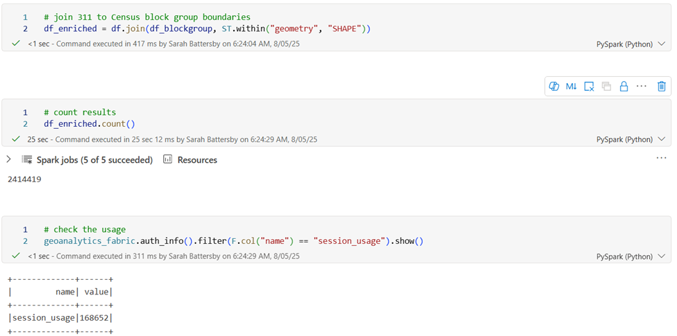

Let’s add in a bigger spatial process to explore core-hour usage.  For this, we’ll perform a spatial join with the ~2.5 million point records from the 311 service calls and the 680 tracts we just read in from a feature service.
After running a spatial join using ST_Within, our total core-millisecond usage for the entire workflow is at 168,652, or 0.04 core-hours.
