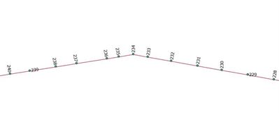

Can I label a points layer perpendicular to a line layer?
6052
15
04-30-2018 05:08 AM
PaulWirth
I have a points layer (Electrical Transmission structures) and a Transmission line layer. The points layer sits on top of the line layer and because the line layer changes direction all the time it is hard to label the points layer sometimes. What I would like to do is label the points layer perpendicular to the line layer.
Does anyone have an answer for me?

GIS_Rookie
Thanks @XanderBakker ! This worked for me 🙂
Just curious about why those numbers are heading to north and south, not in one direction? And some of numbers lost their directions. Maybe there is some kind of explanation? Tried to build 1 script from 2 but without success.

Hi @GIS_Rookie ,
So, ArcGIS has its labeling engine Maplex that has a lot of settings you can play with to get the result you want. I understand that it would be better to have them all point in a certain direction in this case. However, if you have a line that describes a circular movement, it would be best that in a certain location the text switches its orientation in order to be closer to horizontal and enable readability for the end-user.
I also had some issues with the texts near the start or end of the line, not sure what is going on there.
