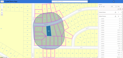

I've already created a project with a Map, Near Me, Search, and Print Widget and configured them so they make a functional Public Notification Tool. I've renamed my Map Widget to Working Map and my Print Widget to Print Working Map. My Crude Demo App currently looks like this.

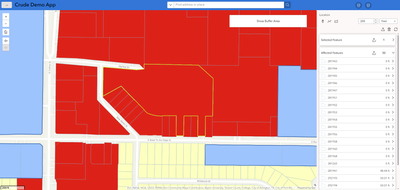

So at this point I have one Map, that looks like the one above, that shows the buffered area and another Map that only has a yellow outline on the selected parcel. (I wish I had an option to make this yellow line thicker, though.) I can click on either map or use the Search Widget to trigger a Near Me analysis. The map areas stay in sync for display and printing purposes.

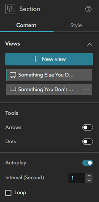

This trick is as stupid as it is simple. Go to the Section Widget and turn on Autoplay. 1 Second Interval and make sure Loop is turned off.
To the user the Map will load, then it will flash and load again. And both Print Widgets will work without issue.
