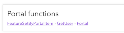

This is a good reference that someone else in the session Chat posted for Arcade expressions:
https://developers.arcgis.com/arcade/function-reference/
If you don't know what group your needed function is in, you are at a loss as I don't see a search function on the page. But if you go to the Playground tab in the upper right, you can use that search tool to help you find the expression name and the group that it belongs in.
GetUser is a portal function, for example. Scroll to that group in the above link and click on GetUser there to see the function description, uses and example code.
