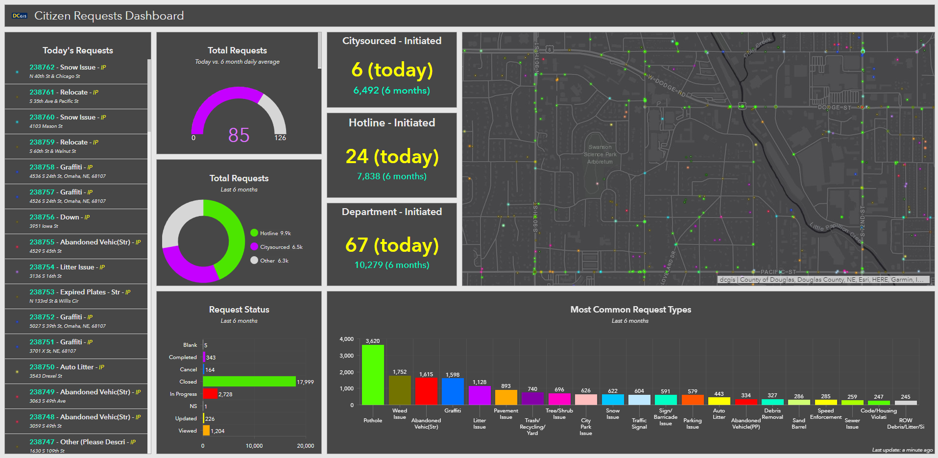

Just wanted to share some really nice example 311 Dashboards, built on Operations Dashboard for ArcGIS. These are real, live customer apps!
City of Baton Rouge, LA - 311 Citizen Request for Service Dashboard
City of Salisbury, NC - 311 Request Dashboard
Douglas County, NE - Citizen Request 311 Dashboard

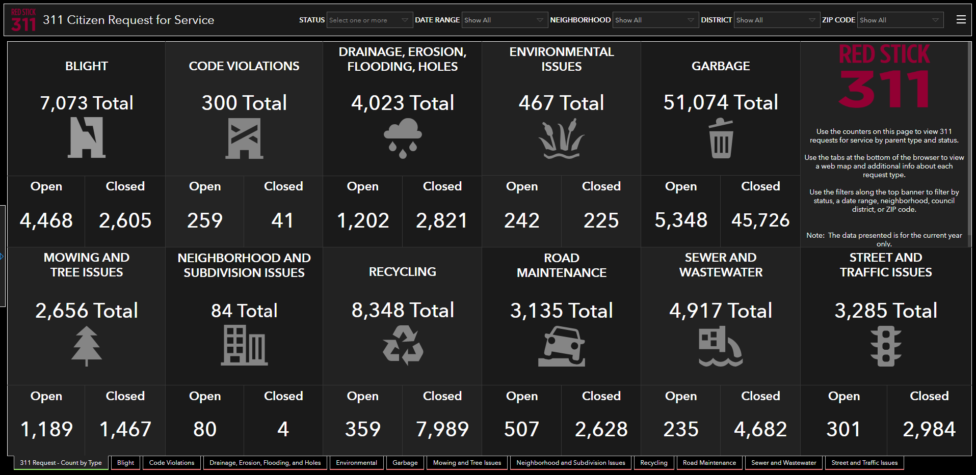

I'm just curious about the dashboard from the City of Baton Rouge, LA. How can they make those tabs separately and the general filter? Is there any custom coding involved?
Thanks!
Hi Vi,
The tabs are created by stacking Dashboard elements, and the general filter is enabled with selectors. All of this can be done with configuration, no coding needed.
Hope this helps,
Hi Derek,
Thanks for your tips. What I needed to learn is "Grouping the elements". It works perfectly!

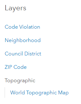

For example, I have a layer of Storm Damage points and a layer of county boundaries. I want to show how many points are in each county on my dashboard.
April,
Our data is available at 311 Citizen Requests for Service | Open Data BR
We are using a few boundaries layers in order to do spatial filters.
I built a web map for every category of 311 call and added the boundary layers to each:
