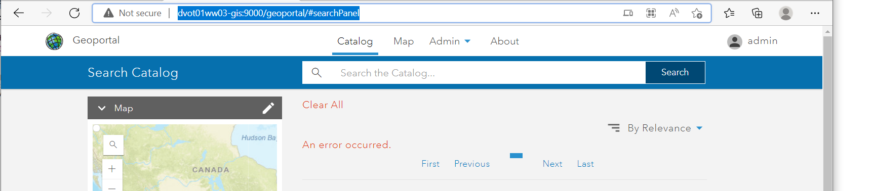

Hello everyone,
When setting up Geoportal 2.6.5 with ElasticSearch 8.1.3 on a Windows 10 VM, I followed the installation steps outlined here:
https://github.com/Esri/geoportal-server-catalog/wiki/Installing-Geoportal-Server-2.6.5
When I tried to start Geoportal in a browser, I got the following error
The exact error message was
{"error":"no handler found for uri [/metadata/item/_search?from=0&size=10&sort=title.sort%3Aasc] and method [GET]"}
I then disabled security for Elastic Search which was on the same VM, as well added Simple Security Manager for Geoportal. I still had the same error.
I checked ES log and there was nothing logged. The latest entries in Geoportal log indicated communcation was good between GeoPortal and ES
2022-06-08 09:47:09,162 DEBUG [com.esri.geoportal.lib.elastic.ElasticContextHttp] - Checking index: metadata
2022-06-08 09:47:09,472 INFO [com.esri.geoportal.lib.elastic.ElasticContextHttp] - Elasticsearch version: 8.1.3
Would anyone has any  suggestions for me to troubleshoot this issue?

Thanks for the API link Marten. It turns out that GeoPortal 2.6.5 would not work with Elastic Search 8.1.3 even when I disabled security in ES. I uninstalled 8.1.3 and reinstalled 7.9.3 ES. And the error I mentioned earlier was not there anymore.
