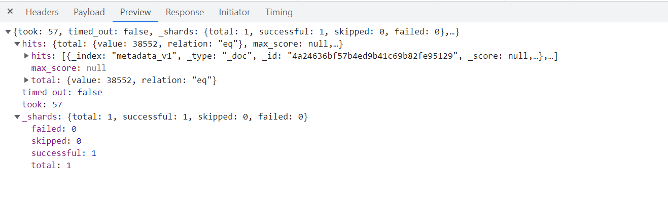

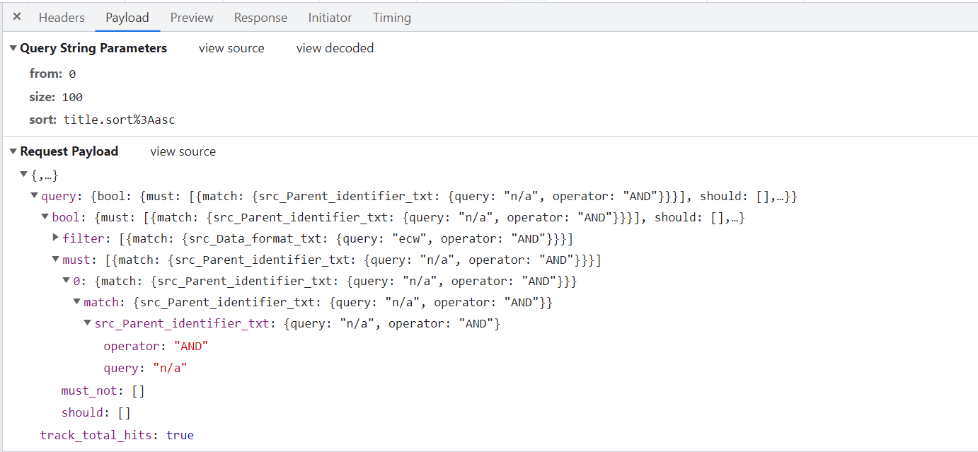

When I am Posting query in Geoportal it is returning single feature set as result and it's total count in DB( Feature set Count Exceeds Default Count :10000).
For Ex:- PayLoad Screenshot below.
Response Screenshot Below:
But For every Distinct Value against a Field in Metadata i am posting individual query with changed field value.
So to reduce the number of posted queries.
Is there any way we can get all the distinct values against a tag and their respective counts in metadata using elastic search if any please reply.

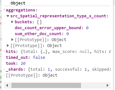

1. we have tried to replicate aggregation query as mentioned below :
 let aggregations = {
      "aggregations":
        "src_Spatial_representation_type_s_count": {
          "terms": {
            "field": "src_Spatial_representation_type_txt_s"
But in response doc counts are 0 whereas it has abundant data in database.
 I am also attaching json sample as a reference if you to have a look.
2.  Is there any problem with terms aggregation if field type is not keyword and is in form _txt in place of _s.
Marten
please note that the field you are trying to get aggregation information for is called: src_Spatial_representation_type_txt, not src_Spatial_representation_type_txt_s
