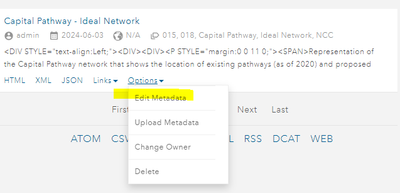

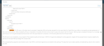

When clicking on the xml hyperlink of an item in Geoportal 2.6.5. The xml hyperlink removes all \r\n embedded in the text. The example I used was Lineage Statement. However if I open the metadata editor or ViewXML on Geoportal, the carriage return is preserved. How do I render an xml in Geoportal like the same way as it does in the metadata editor? i.e preserving white spaces and line returns. This problem can be reproduced using  the attached xml.
