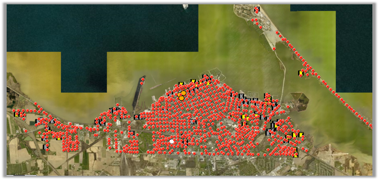

Today I would like to put forward the second largest GIS system that we have currently up and running within the city. The hydrant inventory began as a Fire Department project during my stint as a part-time employee here at the city. 3 guys from Fire agreed to take their phones and a collector app out and pick up as many hydrants as they could. In three days they collected everything you see below:Hydrant and knox box locations
   The above image is where the hydrant inventory stayed until about a week ago. Water Department came to me and said that they were going to start hydrant flushing soon and would like to utilize the GIS capabilities we had talked about months ago. Today we have a beta system in place that is being used in the field as I type this. The workflow looks something like this:

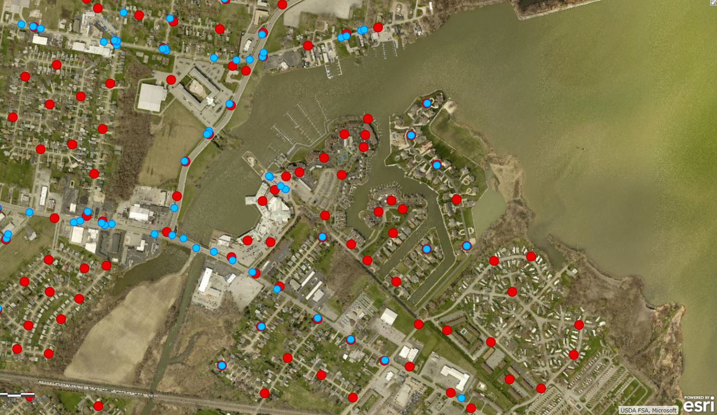

What the map looks like in the feild. Blue are valves, red are hydrants.
Collector map view

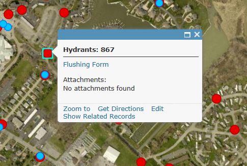

Hydrant pop up with linked Survey123 form

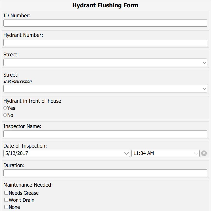

The Survey123 Form is linked directly from the hydrant pop-up. There is a nifty bit of formatting you can do that will auto populate fields within the form to reduce data entry and error. For this form the hydrant ID number auto populates to tie the records.
Quick view of the Surevy123 form for flushing
I will eventually need to restructure the hydrant point file schema to better reflect the workflow for the guys. There has also been a request for a maintenance ticket related table. Just goes to show that a health application/system is always evolving to fit the needs of the user.
