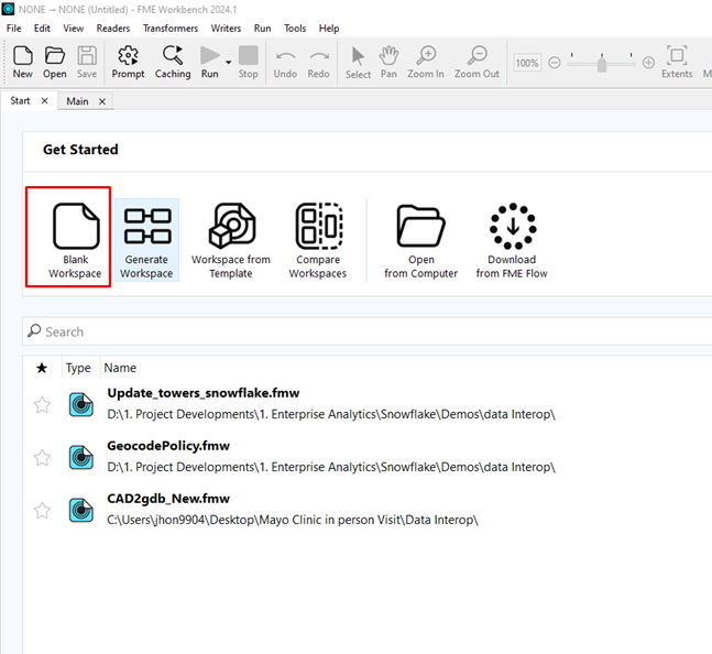

Step 1: Launch the Data Interoperability Workbench
From the Analysis tab in ArcGIS Pro:
  • Click on Data Interoperability and then choose Workbench
 In the new interface, create a New Blank Workspace

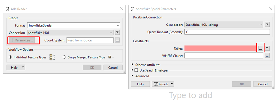

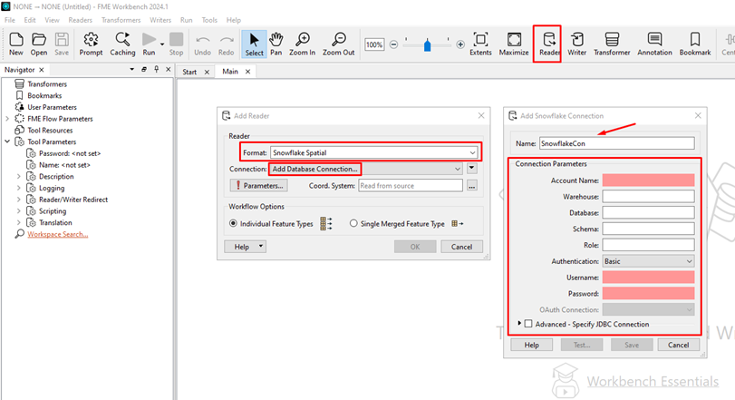

Step 2: Add Snowflake as a Reader
  • Click Add Reader
  • Choose Snowflake Spatial
  • Select Add Database Connection and enter your credentials (server, database, schema, warehouse, etc.)

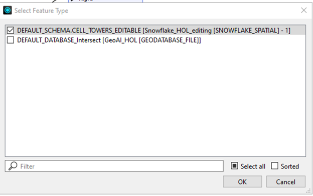

  • After connection, go to Parameters > Tables
  • Select CELL_TOWERS_WITH_RISK_SCORE
  • Click OK

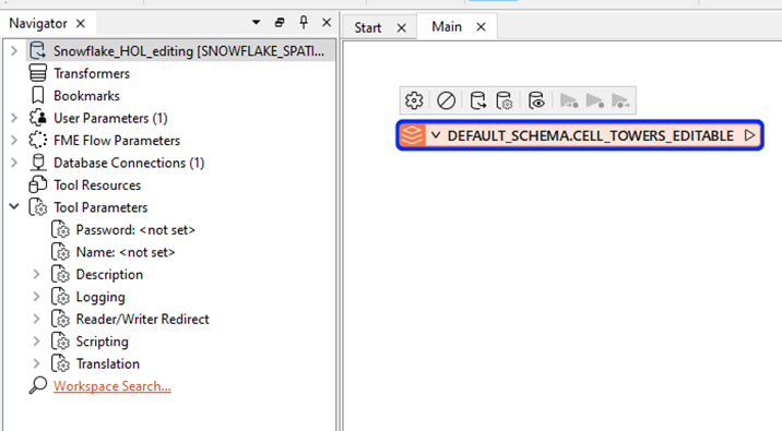

The reader will look like this:

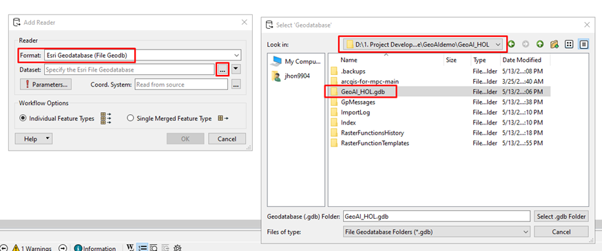

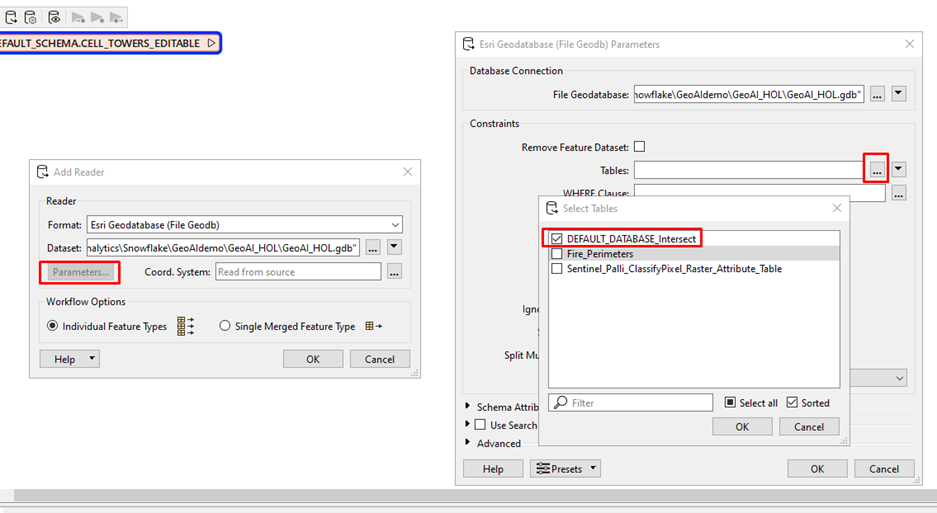

Step 3: Add a Geodatabase as a Reader
  • Add another Reader
  • Select Esri Geodatabase
  • Browse to your .gdb folder included in your ArcGIS Pro project package
  • In Parameters > Tables, select the layer generated from the wildfire intersection (output of Pairwise Intersect)

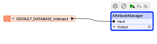

Step 4: Attribute Transformation
  • Add a Transformer: search and add AttributeManager
  • Connect the Geodatabase Reader output to the transformer
  • Open the transformer:
    • Keep only the fields FID_CELL_TOWERS_WITH_RISK_SCORE and AT_RISK
    • Rename FID_CELL_TOWERS_WITH_RISK_SCORE to CELL_ID
    • Set AT_RISK = 1
  • Click OK

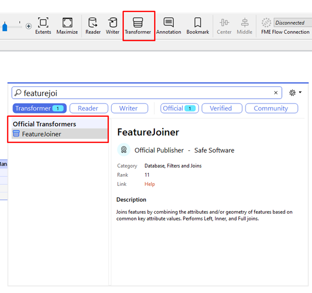

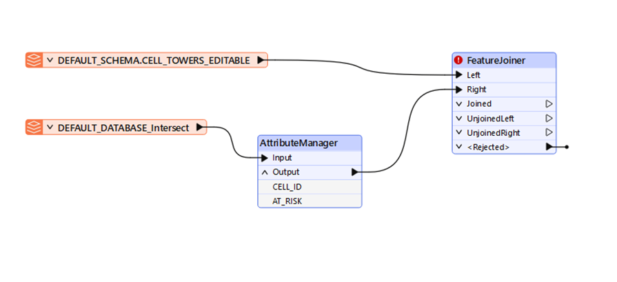

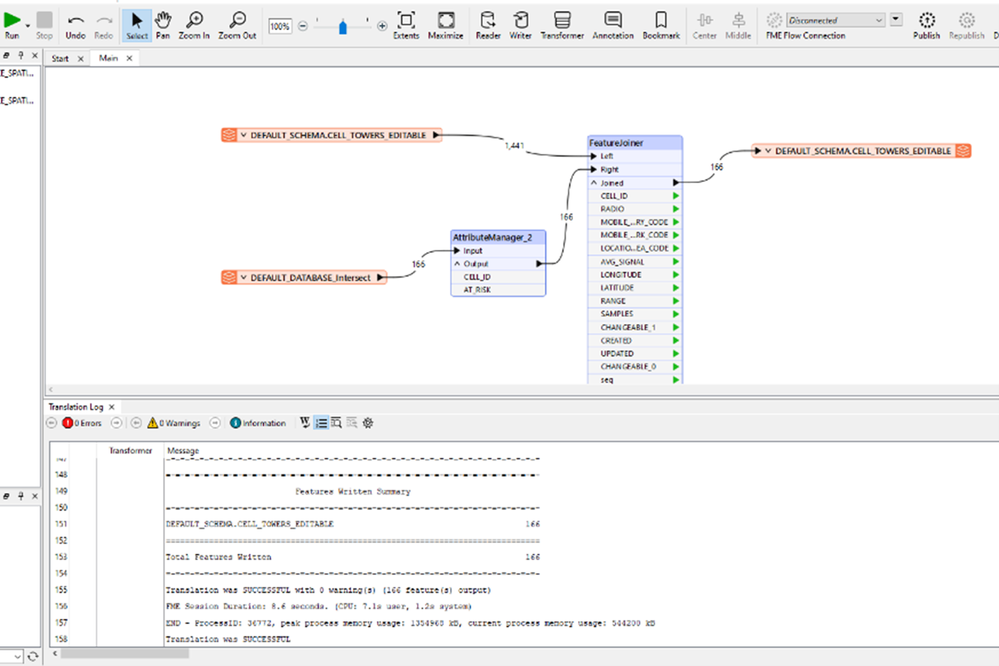

Step 5: Join Attributes
  • Add a FeatureJoiner transformer
  • Connect outputs from both the modified attribute table and the Snowflake Reader

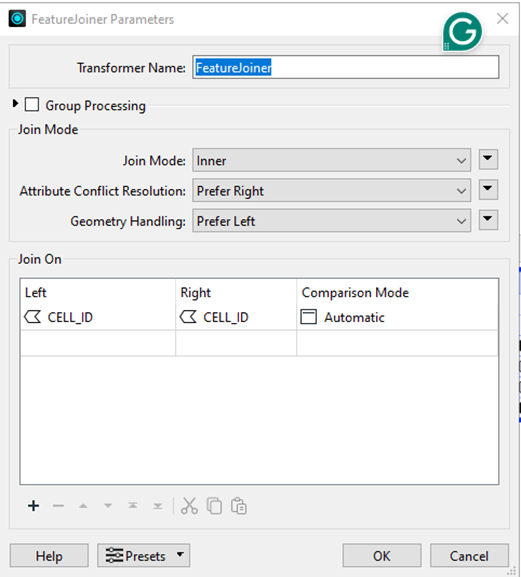

  • Configure join:
    • Join on CELL_ID for both left and right
    • Set Attribute Conflict Resolution to Prefer Right
Step 6: Add Snowflake as Writer
  • Add a Writer for Snowflake Spatial
  • Use the same connection settings
  • In Table Definition, choose Copy from Reader
  • Select the Snowflake Reader table CELL_TOWERS_WITH_RISK_SCORE
Step 7: Configure the Writer
  • Connect the output from the FeatureJoiner to the Writer
  • Open the Writer settings:
    • Set Feature Operation to Update
    • For Match Column, select CELL_ID
Step 8: Execute and Validate
  • Click Run to execute the update
  • Save your workspace and close the Workbench

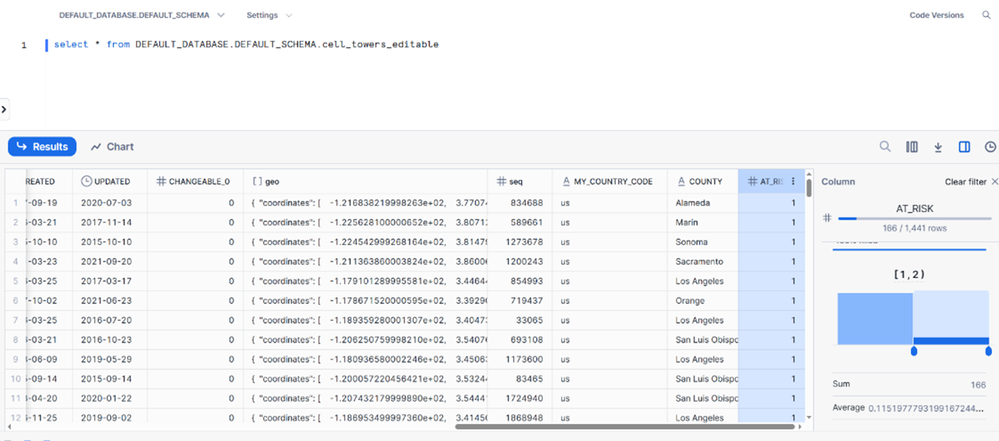

  • Return to ArcGIS Pro and refresh the table view to confirm updates
You should now see that the AT_RISK field in the CELL_TOWERS_WITH_RISK_SCORE Snowflake table has been updated based on wildfire exposure.
