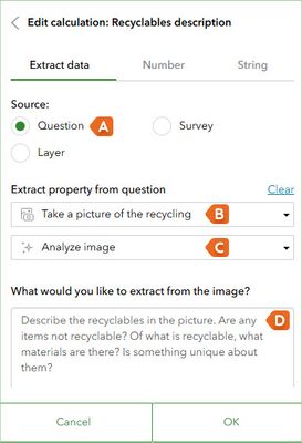

  2. Create your survey in the web browser, including the image you want analyzed to populate other answers in the survey.
  3. For the questions you want to fill out based on the image, add the question and click "Edit" for the calculation. In the "Edit calculation" pane that opens:
    1. Set Source to Question
    2. Under Extract property from question set Select a question to your image question.
    3. Set Select a property to Analyze image.
    4. Under What would you like to extract from the image specify the information to pull from the image. See "Writing the image extraction prompt" below for some tips on writing a good prompt for the extraction.

  1. Ask for the specific information you need; be precise and detailed.
    Don’t ask what the image shows. Instead, ask for the information you need from the image.
    For example, the example survey used the following prompt to describe the image:
    Describe the recyclables in the picture. Are any items not recyclable? Of what is recyclable, what materials are there? Is something unique about them?
  2. Be specific about the answer format you want.
    If collecting a count of items shown in the image, have your prompt include that you want a number returned. If populating a single select, specify when each single select choice should be selected.
    For example, the example survey used the following prompt to determine if the recyclables are indoors or outside:
    Is the image taken indoors or outdoors? Set the answer to "Indoors" if indoors, otherwise, set it to "Outside"
