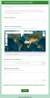

  1. Students collect data through a survey.
    The survey is configured to mark all data as submitted, using a review status attribute field that's hidden from the survey.

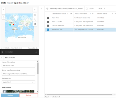

  2. Teachers and other designated individuals review the submitted data.
    They mark each entry as approved or rejected by updating the review status attribute.

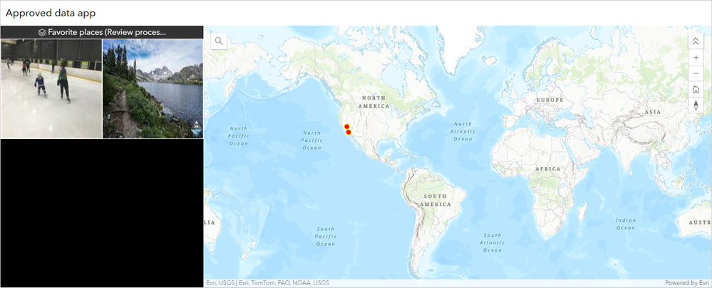

  3. Students use the approved data to answer questions and solve problems.
    How and where they use it depends on what they need to do - you'll configure an app that meets their needs but is restricted to the approved data.
Try it out and see how to set it up
