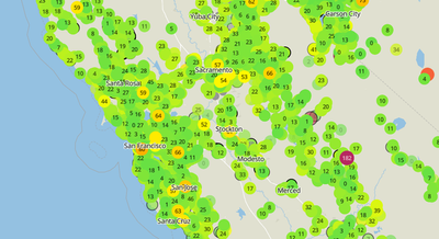

The PurpleAir website includes a map to explore sensor locations and data fields.

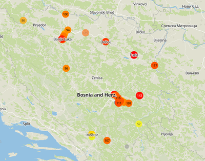

The map shows all of the sensors that have been marked as ‘public’, thereby letting anyone see the data getting captured across the world for all of these sensors… it’s an amazing dataset. Based on the PurpleAir documentation, these sensors are recording data every 2 minutes for attributes like air quality, temperature, humidity, etc. (for the full list, just refer to the API documentation).
Here are a couple screen shots from the PurpleAir map:
Vietnam...
Bosnia...
California...

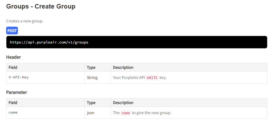

The first thing that I needed to do (the best practice in the API), was to create a group, and then add sensors to that group. In that way, I could send one request to poll multiple sensors. In my use case, I wanted to get all of the data for New Haven, CT sensors.
After creating the group (which will generate a unique ID for your group, write this down!), you then need to add sensors to that group.

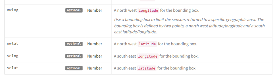

To get the sensor_index for the sensors you are interested in (for a specific geography), you first need to send a request over to the ‘sensors’ API – I ended up using ‘nwlng, nwlat, selng, selat’ to define a bounding box for New Haven.
Here are the bounding box parameters, so you can return the sensor_index IDs for the sensors you actually care about.

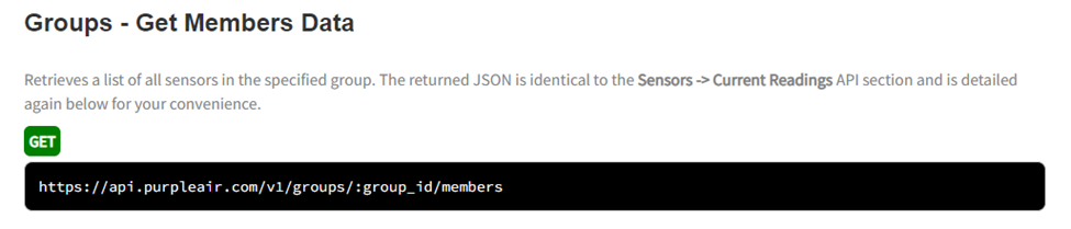

We already created a group and added sensors to it, so now we can use the ‘groups’ API to send 1 request and retrieve data for all of the members of that group.
I hope you remembered your group ID!
There are a lot of different attributes that you can return, so make sure you select only those fields that you need, to keep the request more compact.
You will end up creating a comma separated list of fields that you want to send over in the request. In my example, I wanted to poll for these fields:
name, model, hardware, location_type, private, latitude, longitude, altitude, position_rating, uptime, last_seen, last_modified, date_created, humidity, temperature, pressure, pm2.5_alt, pm2.5_alt_a, pm2.5_alt_b, pm2.5

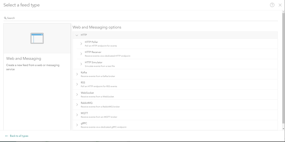

In ArcGIS Velocity, we are going to create a ‘feed’ with the PurpleAir API (with the request we have already built out).
ArcGIS Velocity includes a wide-range of different feed types, for the PurpleAir API, we need to use the ‘Web and Messaging’ type.
This feed type provides a lot of different options and it’s where you can configure requests to a wide-array of APIs.
To poll the PurpleAir API, we will use the ‘HTTP Poller’.

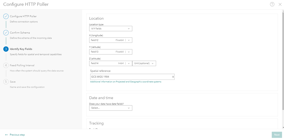

To make it easier to use your data, you can also provide field names that will be applied in the feature service.
If you set names for your fields, it will be easier for you as you assign the key fields, notably the XY, datetime, and your unique ID.

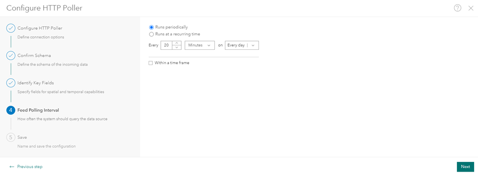

Then we set the interval to send the requests. Make sure that you don’t crush the API with requests! Keep the requests at something reasonable.
