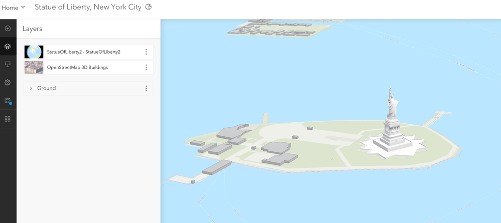

To improve this, we can download a 3D model from SketchFab, add it to CityEngine, and ultimately publish a hosted scene layer.  That scene layer contains the Statue of Liberty and can be added to anyone's ArcGIS Online 3D Scene. The remainder of this blog presents one workflow to achieve this result.

  3. When prompted, add the file and create a hosted scene layer. Screen Shot 2022-07-21 at 12.07.22 PM.png
  4. When published, I recommend sharing the hosted scene service publicly.  Be sure to complete the metadata and upload an appropriate thumbnail.

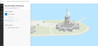

  5. Start a new Scene viewer (3D) map.  Add you new hosted feature service.  You can also add "OpenStreetMap 3D buildings".  If you end up with data from the OSM layer instructing your 3D model, you can use a spatial filter to hide the object as outlined in this blog. (Expand the image to the right to see the spatial join window and obstructed 3D model.)
