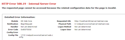

We had a similar issue in ArcGIS Web Adaptor 11.3 fresh install where we installed the .NET hosting bundle 8.0.11 as the first prerequisite install. We saw an error code: 0x800700d.
We needed to run a repair on the .NET installation for it to work.
