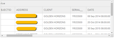

Thanks for the response Johannes. When converting to a string, I'm still having the same problem where, on line 5 above, the filter returns all of my records from the Feature Set again. In other words, it doesn't seem like the filter that I'm applying is actually filtering anything out.
$feature.DATE is a date field, so wouldn't I need inspectionDate to also be a date rather than a string?
I've included a screen shot of some of the rows from my feature set:
inspectionDate is initially September 8, 2014, so I'm trying to filter for every record that's after September 8, 2014. As you can see from the screenshot above, all records, including September 8th, were returned.
