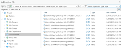

  4. If you are using ArcGIS Online, be sure to choose "ArcGIS Online" under Portal, and then owner:"styles_esri" type:"Style" in the search box to narrow the results down to the military dictionary web styles provided by Esri.   Then select the style that corresponds to the military symbol standard used in the WFS service (for use in web applications be sure to choose the latest version):KerryRobinson_2-1654042051764.png
