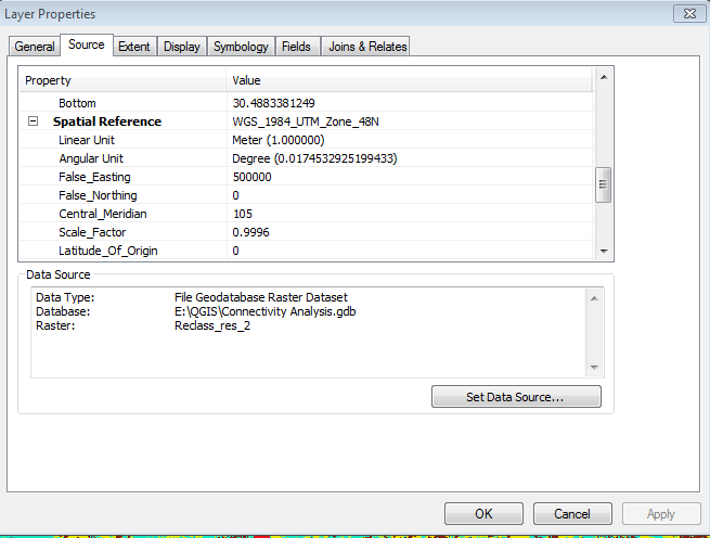

Could you attach snapshot of the current spatial reference and extent of the layer from the layer properties?

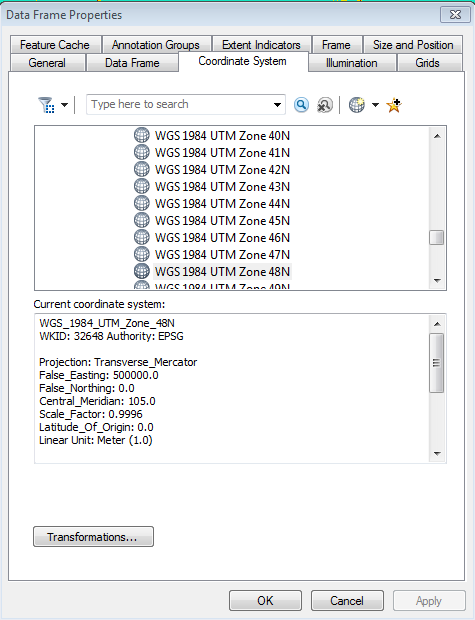

Here are two screen shots:

It seems that the coordinate values correspond to the values in Decimal Degrees (GCS). You need to do two steps.
1. Using Define Projection, define a Geographic coordinate system (GCS_WGS_1984).
This will ensure that the coordinate values corresponds to its correct spatial reference.
2. Next, using Project Raster, you can reproject the above raster from Geographic CS to Projected CS (WGS_1984_UTM_Zone_48N)

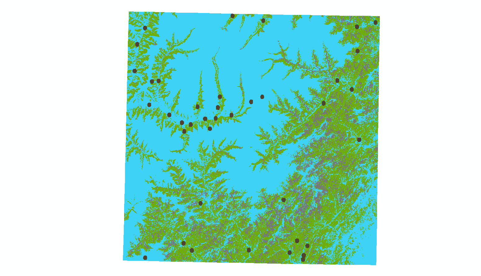

Hmm, after doing this and open them in a new map they are displayed slighlty askew (see below). But I will try the tool that involves the distance calculation anyway and see if it works ...

Based on your comment about the Define Projection tool, I am wondering whether some data layers now have incorrect coordinate systems (projections). For instance, for the rasters that have cell sizes in degrees, what coordinate system do they have? They should have a geographic one like WGS84.
Even if the layers are all using a geographic coordinate system, and the data frame is too, the measure tool should default to measuring geodesic distances and some linear unit.
Because of that, I am wondering whether data frame/layers have projected coordinate systems, but the data (coordinates) themselves are still in degrees.
